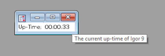

Up-Time counter
Super simple panel that displays how long Igor has been running:

The set variable report uses a font that may not be on everyone's computer. You might simply delete the font selection.
Eventually, someone could add a button to report the up-time to the history (e.g. as a record of some time tracking on an experiment).
Thanks for the snippet!
@jjweimer - I think I have that font on absolutely everything, so much that I forget it's even set. It's part of our facility's identity after rebranding.....
Never-the-less if it isn't available the Igor default is used without error from recollection, though it can be safely deleted or altered.
