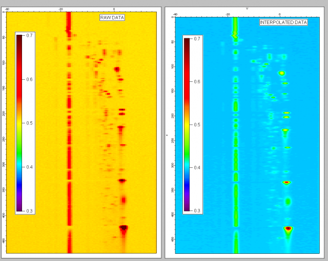

I'm interested in interpolating an image using these iinstructions ;
(...) Duplicate/O $str_spectre_source, $str_Interpolated_spectrum ImageInterpolate /DEST=$str_Interpolated_spectrum /f={8,8}/D=5 spline $str_spectre_source (...)

My problem is that this requirement is not fulfilled. As you can see on the attached files, the max values on the raw data are higher than on the interpolated data.

Would you know why the overall magnitude of the image has decreased ?

You are right, the command line that you used results in an interpolated image with reduced peak values. The reference and the original code used by ImageInterpolate appear to be 6 years older than the 1999 paper you cite in which the authors may have improved on the performance of the original algorithm.
If you would like to perform 2D spline interpolation that retains the peak values just add the (undocumented) /FDS flag to your command line.

Thank you very much, now the magnitutes are preserved. Could you please give us more information about the /FDS flag and the associated algorithm ?
