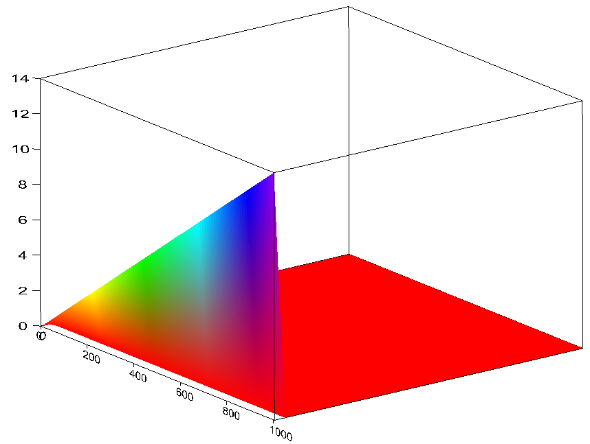

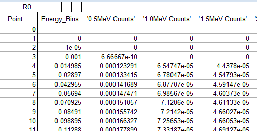

So I'm back with another plotting question. The data I work with is typically imported into IgorPro from an Excel spreadsheet, which as I understand it, causes each column from Excel to become a single 1D waveform in IgorPro. What I'm trying to do is plot a surface from several curves. The image I've attached (IgorData.PNG) shows the data as imported from Excel, the "energy" column should be the x-axis values, while each of the "count" waves represents a unique waveform as spread across the energy bins from the first column.From what I found in the manual it should be a simple process to make each of the "count" waves into a 2D waveform using the concatenate command. What I can't seem to figure out is how to create a surface plot which makes sense with the data I already have. I can concatenate them, making each "count" wave a different layer, but my ability ends there. This does indeed generate the surface (IgorPlot2.PNG), but the units on it do not make sense when related back to the data for each curve, and I cannot figure out how to change the axis labels as I would in a different plot.IgorData.PNG(13.66 KB)IgorPlot.PNG(29.39 KB)IgorPlot2.PNG(98.2 KB)
I'm guessing that your data are sampled on a rectangular grid where the first column in the image corresponds to the scaling in the x-direction. If the sampling is indeed on a rectangular grid you can use the data in the first column to extract wave scaling and apply it as in the post above.

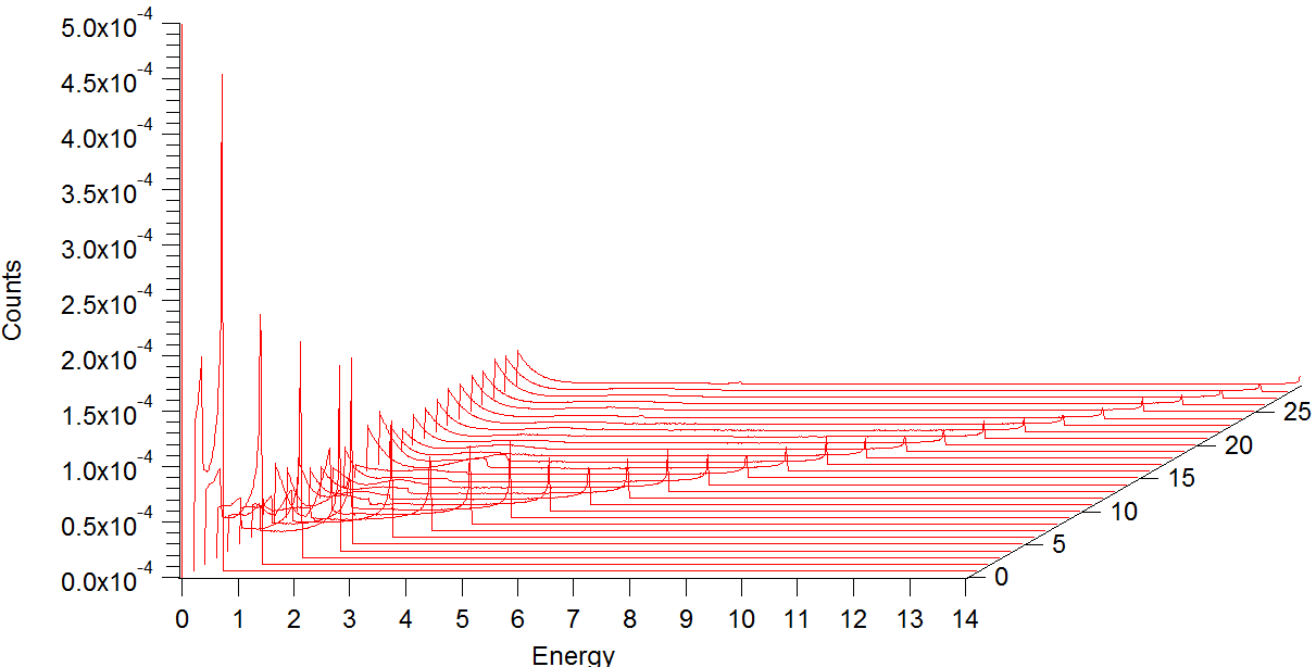

Now you can apply the wave scaling using SetScale (I'll skip this step) and proceed to plot the surfaces. The first plot you have is actually a waterfall.
NewWaterfall surfaceWave
Check the documentation for waterfall plot to find out more about this graph.
If you then create a surface plot from data you have the desired x and y axis.
To display a Gizmo plot you can simply execute:
To find out more about Gizmo plot exeucte:
