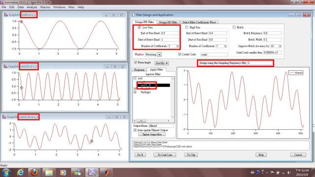

I have some problem for filter, so I did a simple case to understand it.
First,I made three wave cos3t , cos13t and cos13_3t . (The cos13_3t is cos3t +cos13t.)
Then, I made an figure (cos13_3t vs. x_1 , x_1 is x*0.01) and used the "filter" to filter the high frequency data. (cos13t)
My method in the figure,I don't know why I am failed.

To start with, don't use X waves when you're doing any kind of signal processing such as filtering, convolutions, or FFTs; it is extremely unhelpful.
Use the wave scaling to set the sampling frequency of the signal (100 Hz in your example)
SetScale/P x, 0, 0.01, "s", cos3t , cos13t ,cos13_3t
Now when you select one of these waves to filter, the design frequency (which is the same as the sampling frequency when you choose a wave to be filtered), will be properly set to 100Hz.
Click the Filter dialog's "Help" button to read about the Digital Signal Processing (DSP) terminology such as "design frequency" or "sampling frequency".
An FIR filter with only 3 coefficients isn't going to do very much filtering (a lowpass filter won't reject much), and your test signals have almost all of their energy at very low frequencies, as an FFT of those waves will show.
