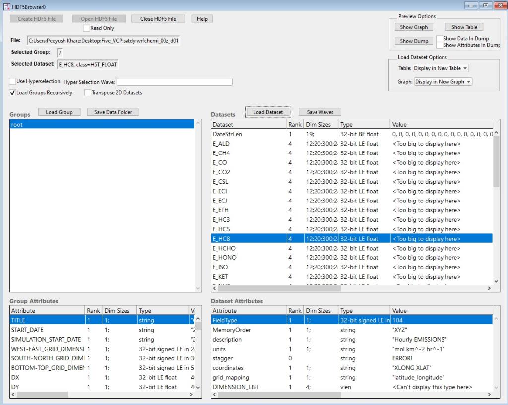

Thanks, actually I don't know exactly how to check the netCDF file version in windows. Please advise. However, since the IGOR HDF5 browser took in the file without throwing any error, I'm assuming it is netCDF-4..?
I have IGOR 8. Below is the screenshot of how the file is looking after uploading using the HDF5 browser in IGOR. How should I navigate from this point? Is it the load dataset functionality?
Sincerely,
Peeyush
March 18, 2022 at 03:37 am - Permalink
Yes, or load group which will load the whole file in your case.
