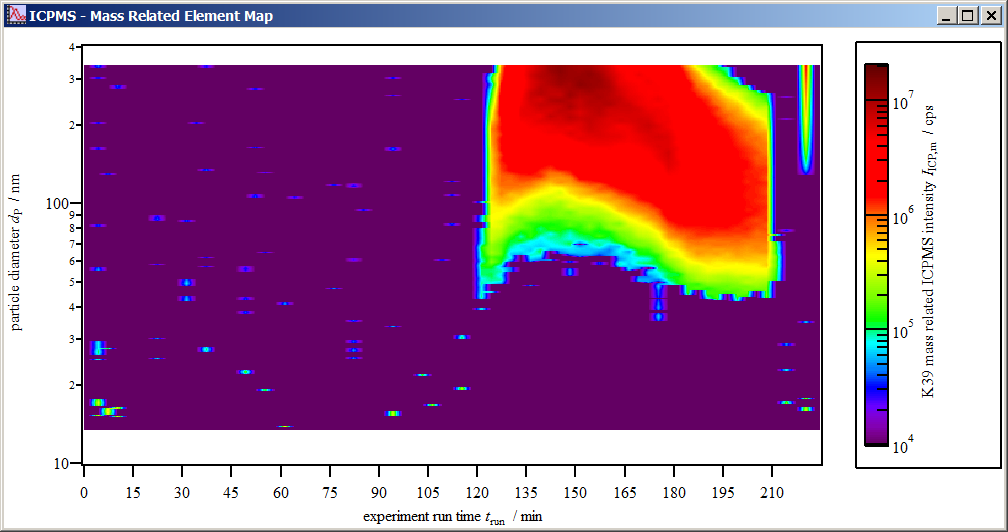

Hi, I am fighting with my color scale.
The distance between the tick labels at the color scale bar and the title appears to scale with the length of the ticks, although the ticks are set to be inside the scale bar (choosing a negative length value, smaller than -50).
Does anybody know how I could reduce this distance, i.e. set the title closer to the bar itself and thus reduce the width of the whole annotation frame (see attached graphic example)?
Best, hea

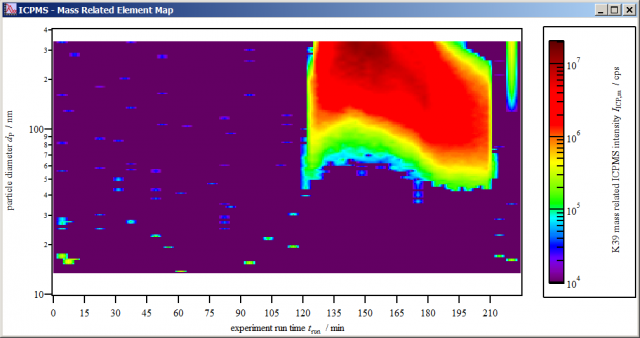

Indeed, I was once at this point but continued trying since I was not satisfied.
This just moves the title towards left, but the frame width is not reduced and the distance between the title and the right border of the annotation frame becomes uglily wide.
Is it possible to get the frame narrower?
Best, hea

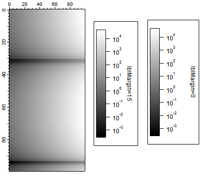

Are you indeed setting the colorscale's lblMargin?
That made the attached color scale narrower.
You didn't perhaps set the width of the Colorscale to something other than Auto did you?
