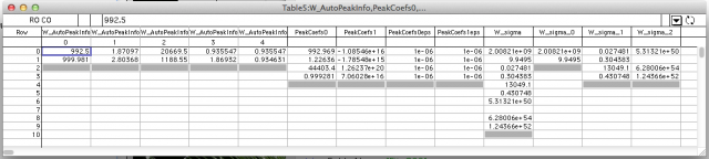

I am using Voigt function and what I need urgently is FWHM with error (along with area +/- error and location +/- error, if possible). If I get the Gauss width and the Lorentz width with errors still fine, I can do further calculation on it. How to get the value from the Peak Coefs.
1. So, I have issues understanding the result. In the image attached , first value is location, then width, height and shape (my guesses) under PeakCoef_n . This is my guess.
But the values from MultiPeakFit GUI are more detailed ( more calculation is done to report those values ). How to get the final values as there.

If you update to Igor 6.36, you will get a version of MPF2_AutoMPFit that adds optional parameters to have it compute the "derived" coefficients (like FWHM), and the various fit curve waves. The function invocation will look like
MPF2_AutoMPFit(... lots of inputs ..., doDerivedResults=1, doFitCurves=1)
See the comments above the function definition in the Multi-peak Fitting 2.0.ipf file.
If the third input is, for instance, "Peak%d", then the fit solution coefficients will be in waves called "Peak0", "Peak1", etc., one for each peak. The errors for the coefficients will be in W_sigma_N, where N is, again, the peak number. If you use the doDerivedResults=1, then you also get "Peak0DER" containing derived results.
You will need to provide your own initial guess with just one peak. You can do that using InitialGuessOptions 0,1, or 2.
Use the latest revision, and doFitCurves=1. You will get the fit curves as part of the result, one set of fit curves in each of the result data folders. See the comments above MPF2_AutoMPFit for the names of these waves.

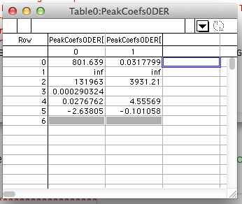

doDerivedResults
works as expected. Nice . {I have a query, the derived data generated has few rows, what do they mean. First is location, then 'inf' ?? After that is Peak Area, then later in following rows should be FWHM ; but the values I get are very low in magnitude. (or maybe I read them wrong !) } Please check the image attached.3.

I think your FWHM is small because the Lorentz width is negative. I'm not sure how the Lorentz width could be negative. It would be negative if either the shape or the original "width" coefficient (which is related to width, but isn't width) were negative. I think either way, it might be an indication that the Voigt shape isn't really appropriate.
So you are using the fit to one peak from your first fit as the initial guess for the batch fit, right? That should be OK as long as any additional peaks in the data set are well away from the location of the peak you are interested in. It may be better to fit all the peaks and then only pay attention to the "right" one.
That inf is the height. The height of the peak involves exp(cw[3]^2) which is the "height" from the fit. It may have been so large that the exp() overflowed. That may be the fundamental problem here. You might be able to get around the problem by scaling your data set to make the numbers involved smaller. You will have to adjust the units too, of course.
