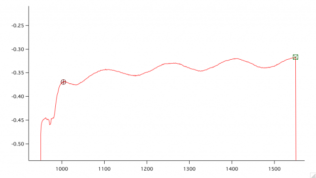

I have some data that shows a low frequency oscillation due to a furnace heating a cooling by a few degrees.
I would like to remove this oscillation.
I did a manual "high pass" filter using a fourier transform and simply deleting all rows with frequency less than 0.01 Hz (it looks like the frequency of the oscillation is around 6E-3 Hz), then did a reverse fourier transform, but that seems a bit cumbersome. (Sure, I could write a program to do it.)
Side question: When doing a "filter" using fourier transforms, is it better to delete the unwanted frequencies or set them to zero?
I was looking into the filter options of Igor, but I couldn't get them to work correctly. I don't know if it's possible to apply them to a section of a wave instead of an entire wave.
I would like to apply a filter to an area of my wave between two cursors, as seen in the picture below.
EDIT: Performing a simple low pass filter is a bad idea. I don't want to lose any information other than the frequency of oscillation (including the overall slope of the wave), so setting the frequencies around the frequency of oscillation to zero seems to do the trick. Of course the ends are messy, but I may be able to play around with that.

Really, all I need out of this information is the slope and overall shape (Does the slope change over the 10 minutes?). Sure, I can do a simple linear fit to get the overall slope. I guess I could represent the data differently, or just trust people will forgive me for the low frequency oscillation.

Not sure what your figure actually shows (no axis labels), but it looks a bit like a "swinging-in" problem.
