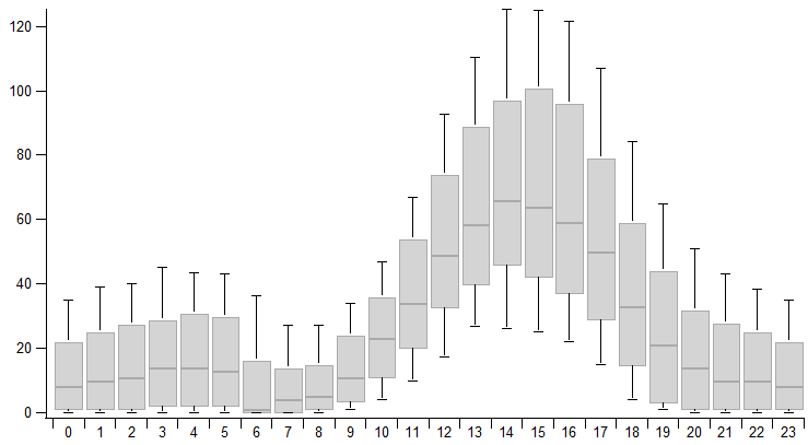

Hi Thiago,
Yes, you can use the fWavePercentile function, as long as you select the data that you want. The Extract function may be your best friend.
Below is a code to calculate the hourly distribution of a dataset (for a box and whisker plot, p1 to p5 should be 10, 25, 50, 75 and 90)
Hope this helps a bit
Cheers
J-E

On your dataset, it gives the enclosed image.

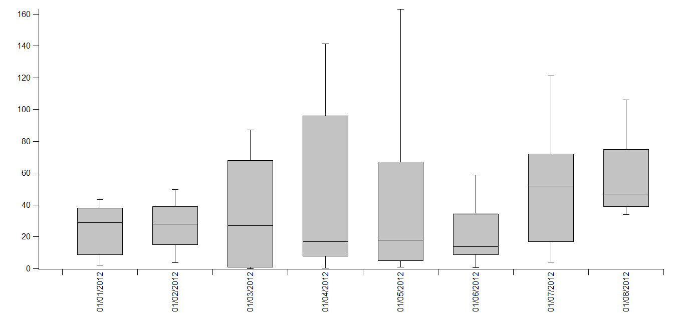

Dear J-E, many thanks for your reply.
I am trying to run the function Diurnal_distrib(timeline,data,p1,p2,p3,p4,p5), but the sintax error appears: expected wave name. Should I create timeline and data wave before? This is not clear for me...
This diurnal distribution will be very useful for me, but I was thinking about the calculation of percentile for each day, as in figure attached. I did this manually, and this took me many efforts. What I should change in this procedure?
Thank you again.
