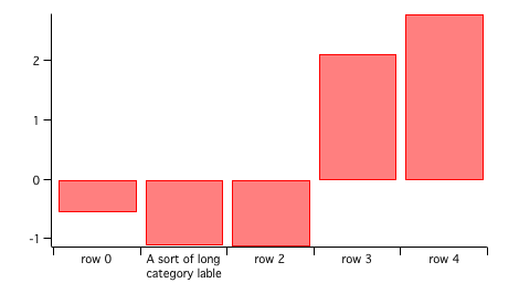

Hmmm... I did this:
•make/n=5/t twave="row "+num2str(p)
•twave[1]="A sort of long\rcategory lable"
•edit twave
•make/n=5 nwave=gnoise(1)
•display nwave vs twave
and the result is attached. Note the second, two-line category label (misspelled) on two lines. That results from the "\r" in the label.
