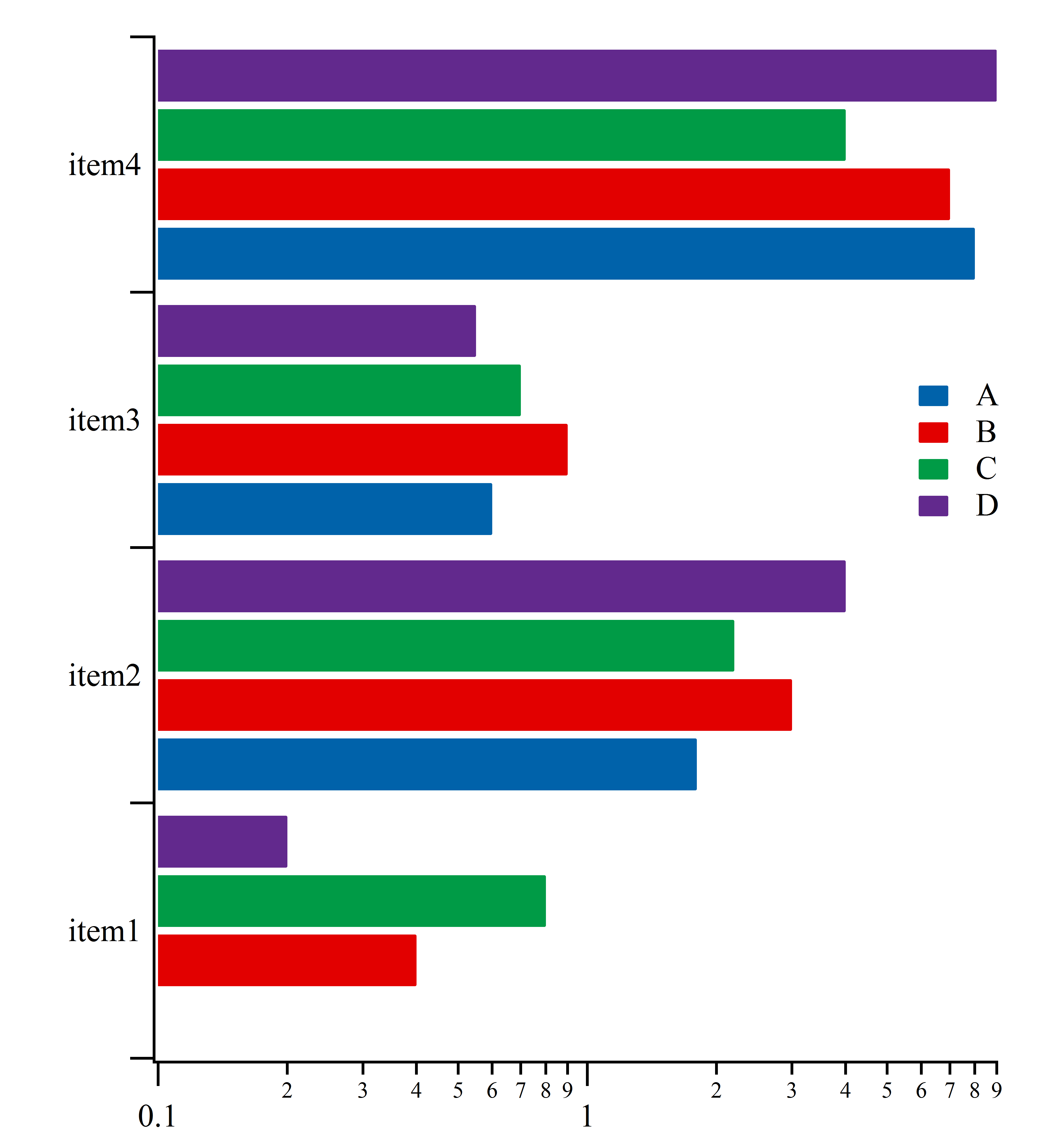

Is there any option to make a category/bar plot, where the bars do not start from zero? In my case I need them to start from 1 and extending in both directions to values ranging from 0.1 to 10.
Additionally I want to have it with a logarithmic scale, which I suppose wouldn't cause any further problems as soon as the first problem is solved.
Attached you see an example done with Excel (which is why I think there is no possibilty Igor can handle this, but I just couldn't find a possibilty)
Thank you for your help and best regards,
Chris
The picture you show has the category axis as the vertical axis, and the log axis is the numeric horizontal axis. You can achieve a similar plot in Igor by making a standard category plot (wait til the end for the kicker!) and set the vertical (numeric) axis to log mode. Then double-click in the margin of the graph to bring up the Modify Graph dialog. Turn on Swap XY and now you have the plot in the picture.

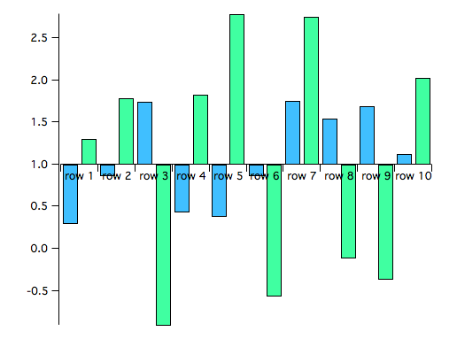

You feed it the name of your text wave containing the category text, then a list of the Y waves, then the number you want at the center of the plot (1 in your case). Here is an example with made-up data waves:
make/n=10 yw1=enoise(1)+1   // "data" wave centered about 1
make/n=10 yw2=enoise(2)+1   // another fake data wave centered about 1
make/n=10/T twave="row "+num2str(p+1)       // a text wave with fake categories
CategoryPlotAroundNumber(twave, WaveList("yw*", ";", ""), 1)    // Make the graph using the function above
This function does not try to color the bars, it does not set log mode, and it does not apply the SwapXY mode to the graph. But it will make the basic graph that you can enhance in any way you wish.
I have attached a picture of a graph that I made using the function. I gave the bars some nice coloring after I made it.
Edited to add a couple comments, and to correct a mistake: the axis position is now correctly set.
