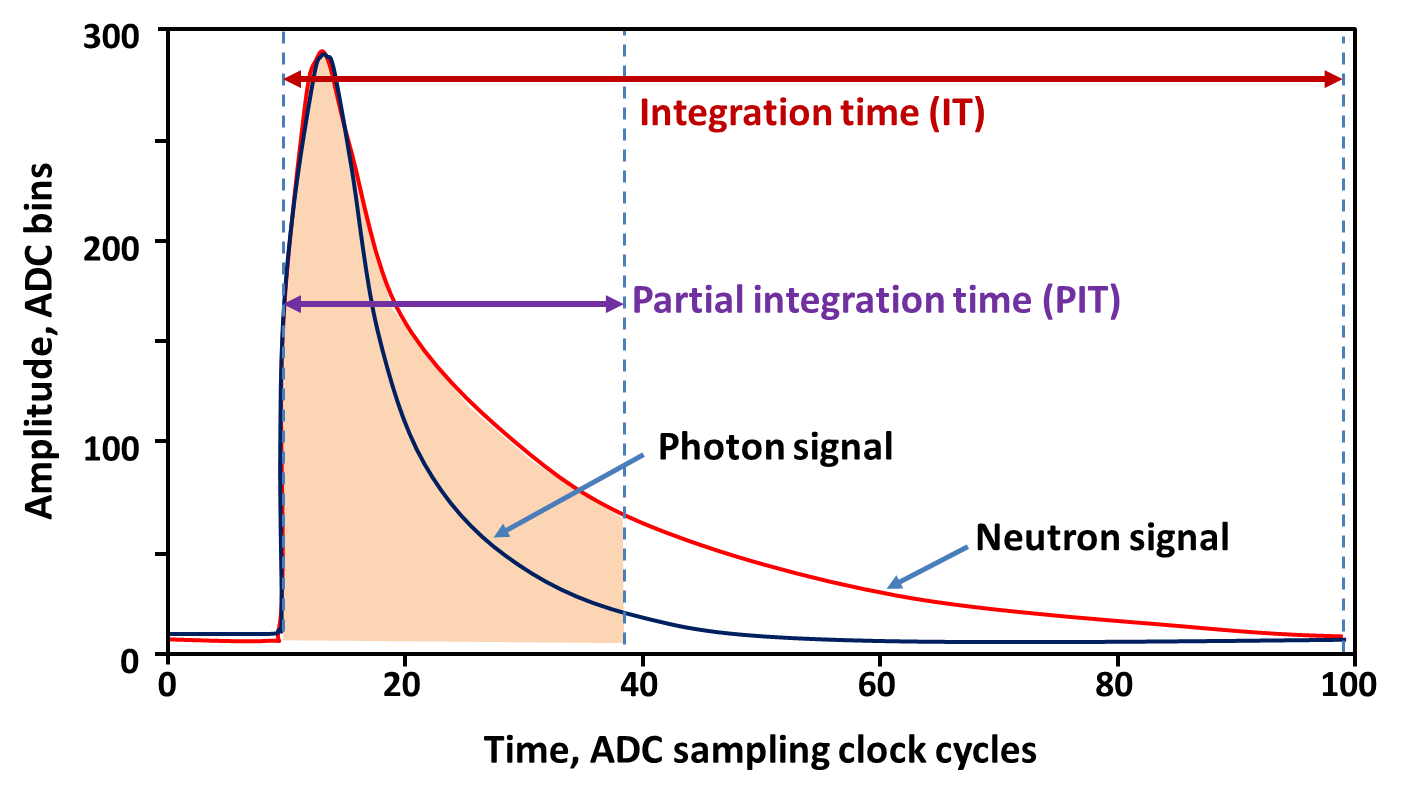

Actually I meant what is the equivalent of the clock cycle for Igor Pro.
I'm looking at pulse shape discrimination using PID value (example in attached figure), but I can't find anything definitive regarding what the software identifies as a clock cycle. The only two comments I've found even remotely close to what I'm looking for are in the following:

It sounds to me like you've confused data acquisition with something internal to Igor. Your graph shows the horizontal axis labelled, "Time, ADC Sampling Clock Cycles". That is a pretty unusual way to measure time, but I presume that it means "units of the sampling clock". To me that would simply mean "data points"- most data acquisition hardware takes a sample every time the sampling clock fires. To figure out what that means in seconds you need to know how the data were acquired, which might require knowing something about the hardware that acquired the data. Or it might mean finding out what the ADC hardware settings were when that particular data set was acquired.

Ok, I'll continue looking into it then.
