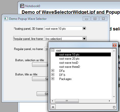

Thank you! Another quick question, the dropbox menu seems only to bring up the current data folder I am working in, any way that I can change this so that I can browse for waves on all folders? Thanks!
nstanell wrote: Thank you! Another quick question, the dropbox menu seems only to bring up the current data folder I am working in, any way that I can change this so that I can browse for waves on all folders? Thanks!
Not really; you'd have to convert to using a panel and wave widget selector controls.
See File->Examples->Programming->WaveSelectorWidgetExample.pxp
[Edit: okay, actually you *could* write a new string function for the wave prompts that iterated all the waves in all data folders and returns a list of the full paths to those waves. The result would be somewhat unwieldy if you have a complicated datafolder hierarchy.]
