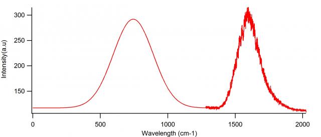

I am sorry to ask this question...probably its too simple ..but I never used Curve fitting in Igor so have very poor knowledge ...so a little help will be great.
I want to make a interface to make simple Gaussian fit on a open Graph, plot the fit results(graph) on top of the original graph and save the results in a notebook. Basically I tried to reuse the codes from hordstein`s (Writing Results of a Curve Fit to a Notebook) code and out it ...some I have a problem ...what I want is to plot the fit curve over the main curve ...but the fit curve get shifted along x axis ( see attac.. picture)...I treid to appendtoGraph...does not worked ..somehow it does not get the x axis of the graph.

My guess, not having your data, would be that your data is in the form of an XY pair of waves. You have both the X and Y waves available in your FitGaussianGraph function, but you didn't include the X wave in the fit. You need
CurveFit gauss yw /X=xw/D
Thank you so much...Indeed that was the problem. now its working wonderfully..
