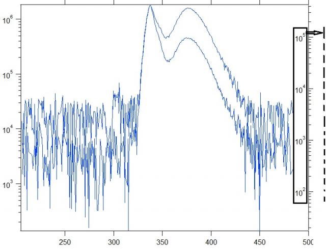

I would like to, after inserting another Y axis, to have the number labels outside the graph box. I will add a picture for a better understanding of what I'm trying to say, I would like to move the content inside the black dashed box to where the dashed line is.
Thanks in advance,
Gabriel
That picture looks like you made a left free axis, and then moved it over to the right side.
You need to make a right axis right from the start. Unfortunately, there is no way to turn a left axis into a right axis conveniently. If you want to avoid having to remove the trace and axis, and then rebuild them, you can close the window and save the recreation macro. Then edit the recreation macro (which will be in the Procedure window) to change something like
AppendtoGraph/L=<free axis name> ...
to
AppendtoGraph/R=<free axis name> ...
