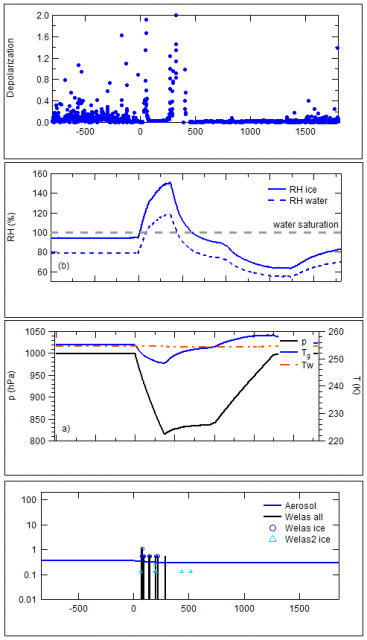

My question is about practical usage of AppendLayoutObjects. This flag defines where should my objects stay "/R=(l, t, r, b )", if I got it correct. However, I can't read the coordinates of my objects when I place them personally. I don't want to stack them and don't want to tile them either. I have four plots and want to place all on a layout. Can you suggest me something?

You understood me correct. I want to place the plots manually, so I need to know the exact coordinazes of each object. So I can use them in a procedure file. Thank you for your help.
