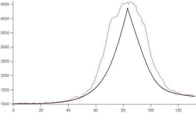

I'm new to Igor, and I'd like to fit an exponential such as the black curve on the attached image. The data to be fitted is in red.
So far I have managed to use the multi-peak fitting function and the curve fitting.

If you're using Multi-peak Fit, I presume you have more than one such peak in your data that you want to fit with that peak shape. Is that right?
The peak shape really doesn't fit that data well- are you sure you want that shape?
The peak shape is a two-sided exponential peak. We don't included that in Multi-peak Fit as shipped, but it can be added with some effort. First you would need to come up with a good user-defined fit function that implements that shape. Do you have an equation? Perhaps Y = exp(-abs(x-x0)/tau)? That would be like this:

return w[0] + w[1]*exp(-abs(x-w[2])/w[3])
If you copy that code into your Procedure window, you can select "twosidedExp" as the fit function in the Curve Fit dialog. It is suitable for fitting a single two-sided exponential peak, but not yet suitable for Multipeak Fit.
