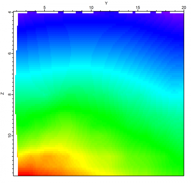

I have a number of files which contain 2 column data (X,Y) measured at some external parameter Z, which is constant in each file for each X and Y, but varies from file to file, Z < < X. When I want to visualize X(Y,Z) I can do so easily by making a contour plot of X,Y, and Z waves. ImageInterpolate makes nice image plot of concatenated waves X,Y,Z too, see attached image.
Now I would like to plot dX/dZ(Y,Z), i.e. a derivative of X with respect to Z for each value of Y and Z. Is there any way to differentiate M_InterpolatedImage with respect to 1 of its arguments? Perhaps extracting X(Z) for fixed values of Y, computing dX/dZ and then concatenating dX/dZ, Z, Y? Thanks!
