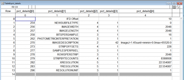

I am fairly new in using IGOR Pro. What I want to obtain is: from a 2D text wave I want to extract 2 numbers and store them in 2 variables so I can use them later in various calculations.
The attached image is an example. From this one I want to obtain the numeric values corresponding to pict_details[2][4] and pict_details[11][4].
Does anyone know how to do this?

Here is a solution:
Function TwoDTextWaveToNumber(tw, row, column)
	Wave/T tw				// Assumed 2D
	Variable row, column	// Zero-based
	String text = tw[row][column]
	Variable number = str2num(text)
	return number

Thank you for the solution but when I try to compile it I get this error:
got "tw" instead of a string variable or string function name
Thank you

Check you have the "/T" in the wave declaration.
Catalin B.
I got it finally. I was using "Duplicate" and I should have chosen the /T flag with this operation also.
Thank you very much for your help.
