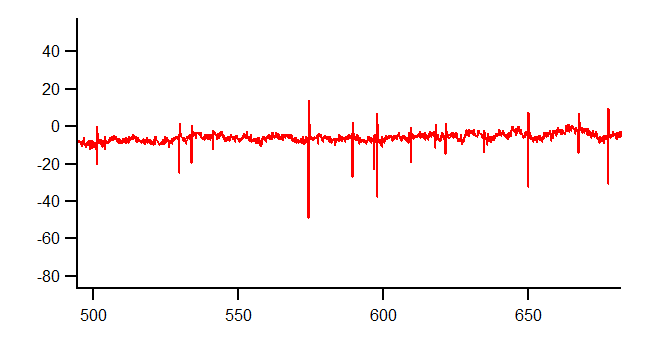

I have some electrophysiology recordings that have some high-frequency noise in them and I am wondering if there is a quick way to remove this kind of noise in Igor. I've attached an image to show the noise - it is the spiky deflections from baseline.

The tricky part here is to give good judgment which data points are considered spikes.

However, your spikes are not really periodic (and also neither high frequency) AND part of the data. For graphing, "dots" might be more appropriate (and these outliers are not that prominent in that case: it's a single dot and not a line to a data point -- give it a try).

Consider the Smoothing dialog's Median algorithm.
Choose Replace: Outliers, and enter a value that triggers replacing the spikes by the median when the spike deviates from the median by that amount (the dialog is more concise than I am here). Start with 5, perhaps.
Compute the median over a smallish number of points, I'd start with 7.
