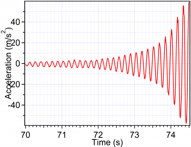

Hello all,
I am trying to fit my experimental data to complex exponential signal. I tried to use:
Curve Fitting -> Function -> exp
However, it seems like igor fitting function assumes only real coefficient since I could not get any meaningful fitting. Is there a way to fit complex exponential function?
I am also attaching igor file that contains data.
Thank you for your time
temp1.pxp (1.6 MB)

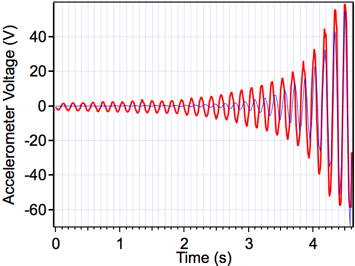

Maybe something like this:
Function ComplexExponential(w,xx) : FitFunc
	Wave w
	Variable xx
	//CurveFitDialog/ These comments were created by the Curve Fitting dialog. Altering them will
	//CurveFitDialog/ make the function less convenient to work with in the Curve Fitting dialog.
	//CurveFitDialog/ Equation:
	//CurveFitDialog/ f(xx) = C * real(exp(cmplx(ar, ai)*xx))
	//CurveFitDialog/ End of Equation
	//CurveFitDialog/ Independent Variables 1
	//CurveFitDialog/ xx
	//CurveFitDialog/ Coefficients 3
	//CurveFitDialog/ w[0] = C
	//CurveFitDialog/ w[1] = ai
	//CurveFitDialog/ w[2] = ar
	return w[0] * real(exp(cmplx(w[2], w[1])*xx))
I was unable to find a good ai to match the frequency of your signal, and the fit isn't really great. But at least it's doing something... :)
