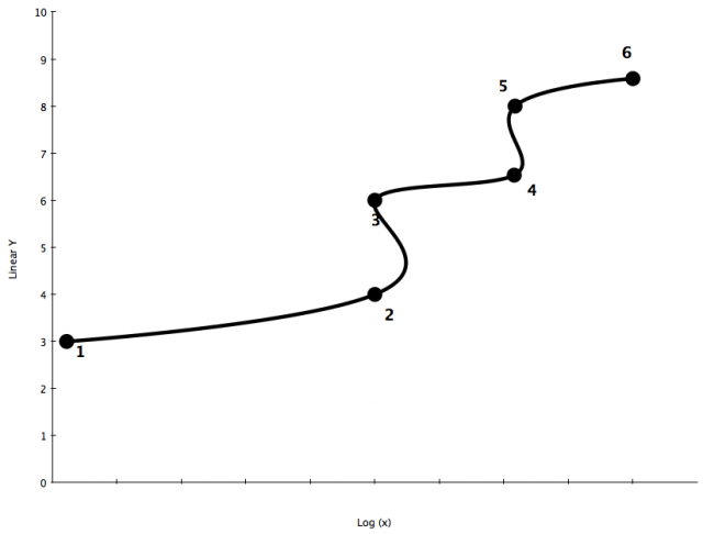

I want to fit a curve through 6 points (please see figure attached, the curve in the picture is a drawn one not a fitted one. That is just to give a feel how the fitted curve would look like.) in a log-linear plot. Is there any way I can do it in igor? Thanks.

I don't think you really want to "fit a curve". You probably want a spline curve or bezier curve. Since your curve is not a function (there are places where it has multiple Y values for a given X value), you will probably have to draw it by hand using Igor's drawing tools.
I think the log axis may cause problems, too. I would make a new X wave containing log(x) and plot on a linear axis. Then use Igor's drawing tools to create a bezier curve.
