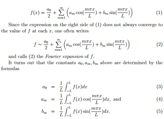

I am trying to implement the Fourier Series (attachment1: "fourier_series") on Igor as a programming exercise. My biggest issue is integrating. While calculating the integral, I'm not sure how the variable of integration should be declared. Because "integrate1d" uses another function (usr function) to calculate the definite integral, should I declare it in the usrf?. The code I have written is
For various reasons it may not be a good idea to try and compute the integrals directly but that is not the central issue of your question.
Your user functions for Integrate1D should return the value of the integrands for an input parameter (say inx). Since the functions take only a single input parameter you need to rely on global variables to access 'm', 'L' and the data in a wave 'func'. I would use a couple of functions. The first is used to interpolate the data in the wave:
