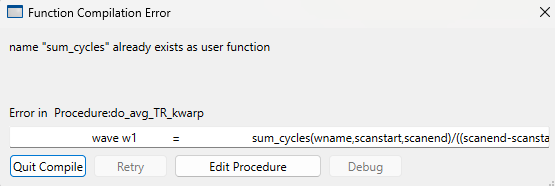

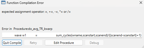

I am getting an error that a function already exists, but if I remove/comment out that function, it shows that error because that function no longer exists.
So weird!! never faced this problem until Igor 9!!!!
Hmm... that seems indeed strange. Can you reduce your code to the minimal possible example where this happens and then post a self-contained experiment file here? I (seldomly) have weird compile issues which go away after restarting Igor, but I assume you tried this already?
This is just a bad error message; there is no duplicated function, the error message means to say "you can't use this function to assign to a WAVE reference:
This will be fixed in the next Nightly Build of Igor 10 today or tomorrow.
