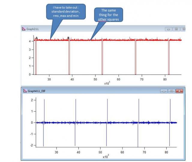

i'm working in an project, and my programm does not work yet .
my issue is to do some traitment to the signals i have, more clearly i have a periodic square signal , and i have to take out the standard deviation, the mean, the max and mean of every square( in the attatchment a pic thas explains all) without passing through null values.
my methode to do that , is to make a a differential of my signal , and after that i can identify the rising edge and the falling edge, and finaly identifying the square by placing cursors A,B and making the statistics.
program code

First, I recommend you to use the "preview" button to preview the post when writing an entry in the forum. Use this button and read your post again carefully to spot errors. Ambiguous text or function code only makes it harder to understand the problem. Also, if you find something after you have posted your entry you can use the "Edit" button to correct something.
Now, generally it would be better to write "functions" instead of macros. You are not writing what exactly does not work, so I take some guesses. There seem to be some issues with the assignment of "XL1" and "XL2". Are you using the output of the first
Findlevel
function somewhere? Also, there is no initialization or update of the variable "XL1". Do you use some other function for that? You might want to check the values of "XL1" and "XL2" during the run using the debugger to make sure it does everything as intended. Hope that helps a bit.
