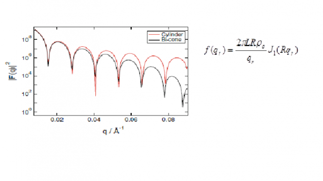

Hi all.
I am extremely new user to IGOR. I am trying to plot a graph exactly as in the attachment (but only for a cylinder). The calculated form factor for the hard cylinder is given in the attachment as well. When I try to write my own procedure, it doesn't work then today, I found this example of code in IGOR Help Browser. If I want to use this code, where should I put the form factor equation (as in attachment) and how can I define all the variables? There's is also a first order Bessel function in the equation.How am i supposed to define it in this code? I really need a help because this is the first time I am using IGOR and I am not familiar with coding. Thank you in advance for the help.

Here's a simple function which generates the type of data you want. You can display this in a graph afterwards.
Call the function by executing
FormFactor('value of L times roh', 'value of radius')
(e.g.,
FormFactor(2,50)
) in the command line.
It is of course also possible to input L and roh separately, but you might try to modify the code as a small challenge yourself. ;)
Function FormFactor(Scale, radius)
	Variable Scale, radius					// scale, radius as input (scale = L*roh)
	Make/O/D/N=1000 FF_data				// create data with 1000 points
	SetScale/P x, 0.001, 0.001, FF_data		// x scaling! No need for separate x data
	FF_data = 2*Pi*Scale*radius/x*BesselJ(1,radius*x)	// Bessel function built into Igor

Thanks Chozo! One more question, from this command: IR1T_GenerateGMatrix(R_FF,Q_wave,R_dist,powerFct,"form factor name",param1,param2,param3,param4,param5, "", ""), where can I get the "form factor name"? Is it the name I can give myself or something I can get from IGOR?
elle
Hello again. I was able to make it work!I am getting excited to explore IGOR.Thanks a lot for the help Chozo!
