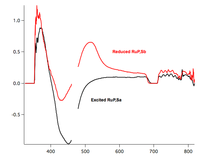

Code follows. I've attached an image of the spectra for Sa and Sb, which don't have analytical expressions. Thank you for the advice

Thank you, my apologies, the new fit function did not generate the code with the function names, I have changed this and it compiles. Unfortunately, the results of the fit do not match what I get when I manually do the linear combination. I don't think the code is getting the source data correctly. The Y data points in Sa and Sb spectra are not evenly spaced. I think the code needs to reference the XY (wavelength,signal) data in the code. Is there a way to reference the XY data?

I assume then that you have a wave to give the x_scaling and that you display your data (picture you gave) doing:
display wave_y vs wave_x
If your wave giving the x axis is monotonic (I suspect it is since you talk about wavelength) you might succeed using the following to define your functions

Thanks John, this certainly speeds things up. While the fitting is quite improved, the fitting results don't quite match up with the results I get with the manual calculation. I think this is most likely attributed to my x-scaling. I have an x wave with data points 352.826, 353.309, 353.782, 354.274nm...., x data points are separated by about 0.50 nm. I've tried 'XY Pair to Waveform' and interpolation but my fits are still off. Any suggestions?
