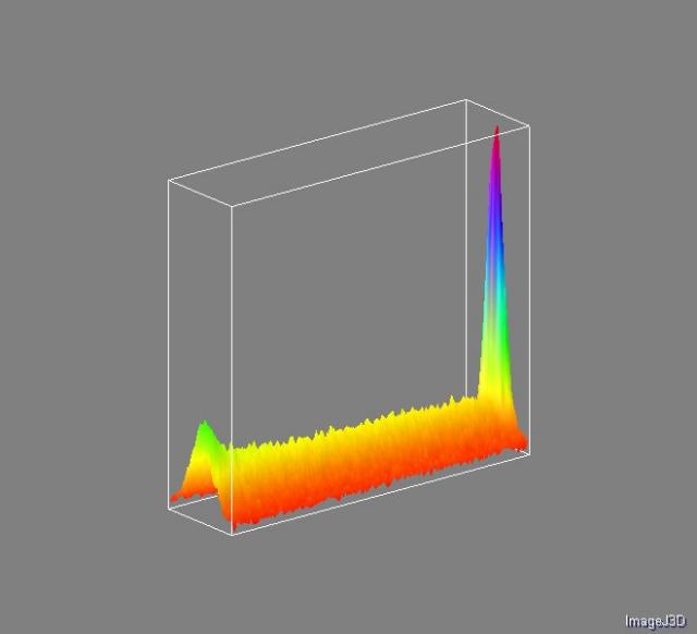

Relatively new Igor user here. I found this video on 3D plotting (https://www.youtube.com/watch?v=8j59XDL7rps&index=1&list=PLLe6A3jhXW3HG…) but unfortunately they didn't show the data used to make the plot. I have a csv file (attached to the post) of X-Y pixel intensity. My hope is to import this data into Igor pro and then use the Windows>New>3D Plots>Surface Plot feature to create a plot similar to the one attached.
My question: given my data file, how do I use Igor to format it in such a way to create the desired feature plot? I have found a few posts on 3D plotting but none seem to address this issue. If I have overlooked a previous post, please let me know. Any help you can give is appreciated.

If you have a text file I'd use the Load Waves dialog (Data Menu->Load Waves->Load Waves...) and choose "Load columns into matrix. I do see your file name contains .xls which suggests an Excel file. In that case you could start by loading your data using Data Menu->Load Waves->Load Excel File...
Regardless of how you load your file, you need to end up with a 2D IGOR wave containing your data. The easiest way to display a 2D matrix as a surface is to right-click on the name of the wave in the Data Browser and choose Gizmo Plot.
Once you have your initial/default plot you may want to enhance it a bit. There are many ways to do that but if you want something that looks like the image you posted I'd first add a gray "clear color". To do that you right click in the Gizmo window and edit the background color. Again, from your example, the second change that you may want to do is to enforce aspect-ratio. You can do that by executing:
ModifyGizmo aspectRatio=1
Although the image you posted does not use shading, you may want to add shading to enhance your graph. You can follow the video tutorials about shading or simply edit the surface object properties and check the Calc Normals checkbox. You then need to add a light object in the object list and drag it to the top of the display list. Typically you may also want to drag the axes object to the top of the display list so that it is not affected by lighting etc.
