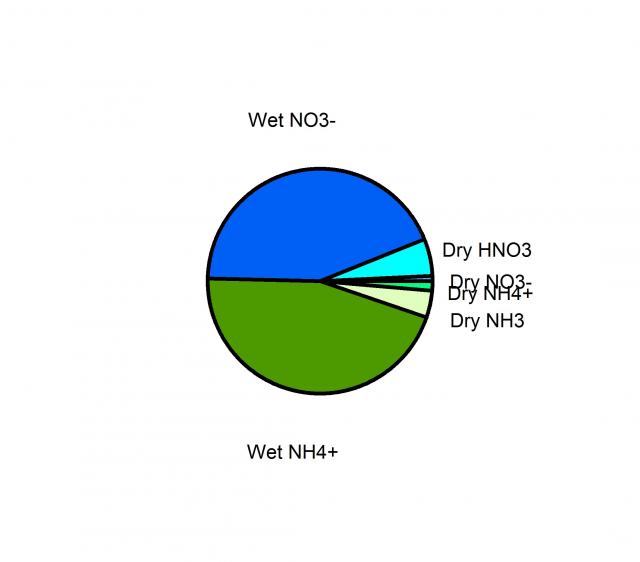

Hi Folks,
I tried to make some 2D pie charts. But I have a very painful problem.
The labels on some pie charts were too close and was not good for read(please check the figure I attached, "Dry NO3 and Dry NH4 ").
I can move them but after re-open the file those labels went back again.
I tried to change the labels position from "Moveable to Frozen'
But it still will go back when I reopen the file.
I had more over 50 pie charts so I could not re-adjust them one by one every time.
Is there someone can help me solve this problem ?
Thank you very much.
Best Regards,
Yi
JimProuty
Turn on "Delay Automatic Updates" at the bottom of the 2D Pie Chart panel.
That way when you re-open the panel, it won't recreate the labels in the original positions.
lyggd
JimProuty wrote: Turn on "Delay Automatic Updates" at the bottom of the 2D Pie Chart panel.
Thank you very much, Jim.
That's totally help !
