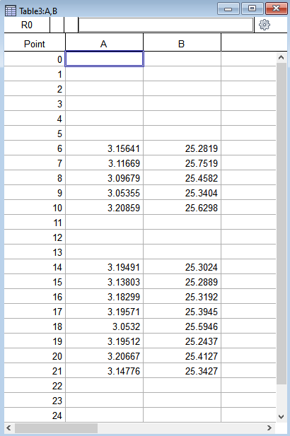

Hi, I have long waves with uneven bits of data. I would like to get the mean and std. of each bit, how could I do this? I guess it should be a loop that goes from one bit to the next, but I don’t know how to do this.
I'm not super certain of what you're asking for... below is a snippet that will return a 2D free wave with the average and standard deviation of each contiguous chunk of data only; so, e.g.if there are two contiguous chunks like shown in your image, then the result will be a 2x2 matrix. There may be more efficient ways to do this, and you may not want just the values if you have timeseries data for example.
