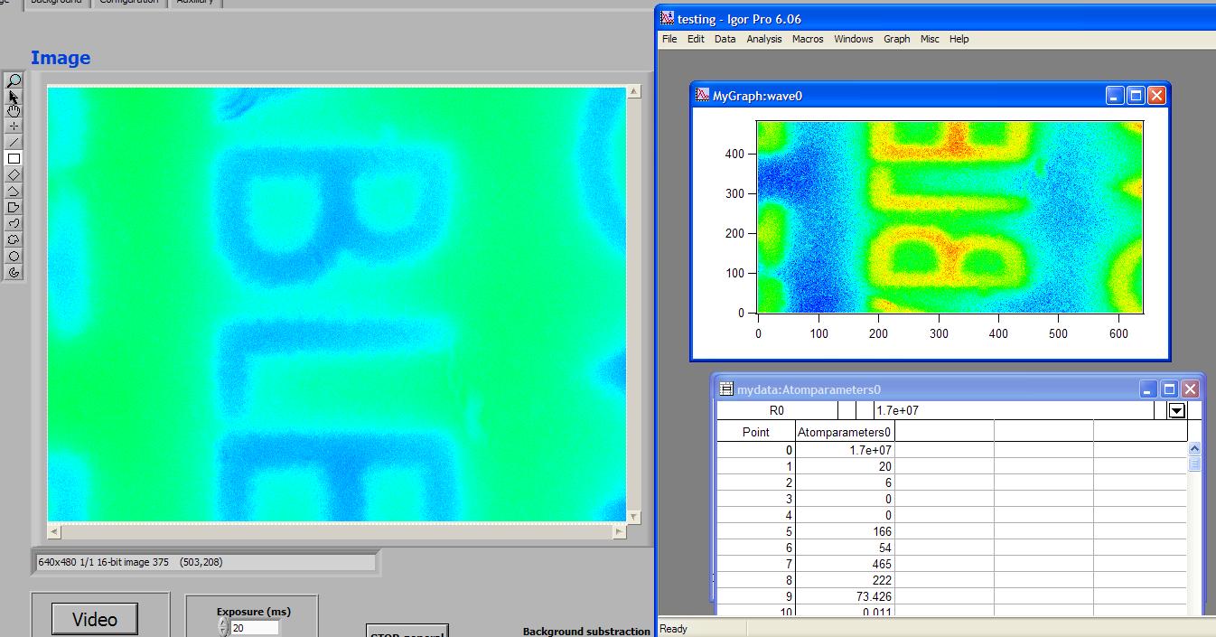

I am using Igor to investigate my Image from Labview.
As you see in my attachment,Igor turns my image in vertical axis.
Does anyone know how to see my image exactly the same?

AppendImage/T changes my axis but not my image.
I replace the Display and AppendImage lines with NewImage, I see exactly the same image, But for every image which loading, one Graph is open. How can kill them?

You just need to reverse the left axis to flip the image from top to bottom.
In the Modify Axis dialog's Axis range tab, change the state of the Reverse axis checkbox.
