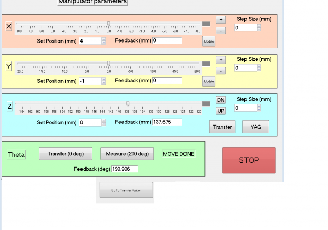

Hi. I am using IGOR to create a GUI (graphical user interface) to control 4 stepper motors. I can control each individually, and I am attaching a screen shot of the GUI so you can see what I have done. Using the IGOR2Epics XOP I can get, monitor and push variables to process variables from the Epics program.
My problem is a programming one. I want to move each motor in sequence, so that they can move to pre-set positions one after the other. This means that I need a procedure that tells the motors: " Motor 1 go here. Motor 2, wait until Motor 1 is done moving. Motor 2 go here. Motor 3, wait until Motor 2 is done moving. Motor 3 go here etc." For machine safety I need to be able to stop the motors with a push of a button at any time, and this must be easy because other people will be using the motors. I have a "STOP" button that works well for this.
My problem is this: When I tell the motors to wait, either using a for loop or a do-while loop it takes over IGOR so that I can no longer use my "STOP" button. I have tried making the "move-wait-move" procedure a background function, but then I get no updates on the main interface and my "STOP" button will still not work. I must abort the procedure before doing anything else.
Do you have any suggestions on how to put in a waiting period that will still enable me to use the GUI in the meantime?
