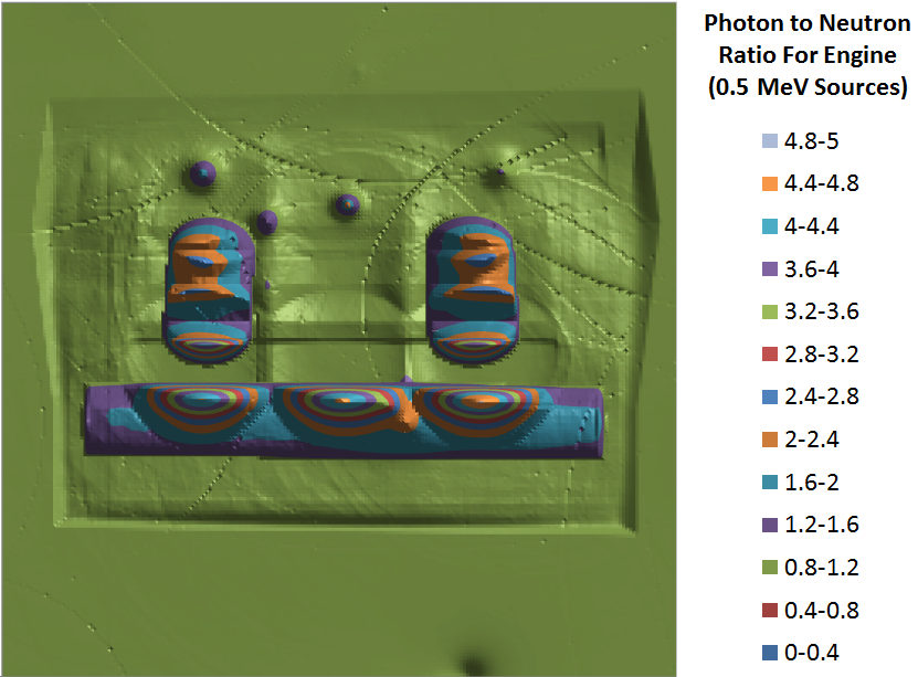

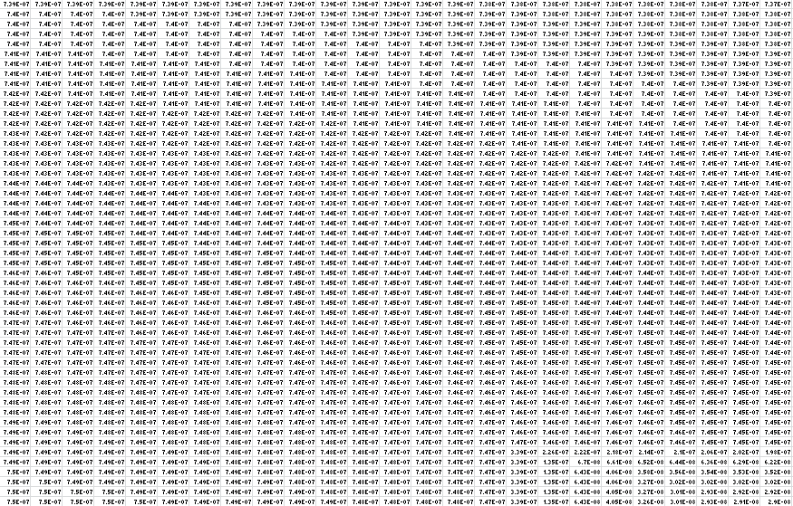

I am working with another program called MCNP to generate radiography data. Basically we place an object between a neutron/photon source and a grid which is used to collect data. Based on the interaction of the source particles with the object, it's "shape" is then projected onto the grid, like taking an x-ray. This radiography data is then imported to excel in the form of a 200x200 matrix (ExcelData.PNG - just an example) and used to create a plot similar to an elevation map, where the color of each pixel relates to the value of a unique cell in the matrix (05Vs05_Flat.PNG). As I've done in the past I usually load the data from the Excel file into Igor Pro by using Data -> Load Waves -> Load Excel File... then defining the desired file name, worksheet, and cells as needed.

Because that is just as inconvenient if not more so than loading the data into Igor Pro... the original data is produced in a text file with unique formatting features that make it difficult to load into other programs. The PNG file is a copy of the Excel plot I had used previously. The whole point of doing this in Igor is that the plotting styles and features look cleaner then most of what Excel can do. I would rather learn how to properly import the numerical data used to generate the image then try to tweak a png file of an excel plot after the fact. If I can get around using excel entirely I'd prefer it but I'm still trying to get a handle on Igor Pro's capabilities.
Thank you for the link. It looks like the image has been flipped 180 degrees across both the x- and y-axis but there is at least a picture now!
