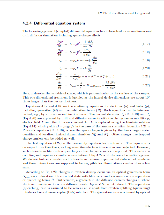

Could you write out (or make a picture of) the equations you are solving?

I tried to simplify my system of equations, removed recombination (pw[4]*yw[0]*yw[1]) and substituted some constants. So, now there are not such big difference of magnitudes. But error is the same, how I can see the magnitude difference is still big. I'm not sure if it's possible to make system of equations with another parameters or to simplify more. But, yeah, when I made all constants (PP={...}) with one order, the code worked.
Do you know what could I do with my problem?
I've attached documents of my system of equations.

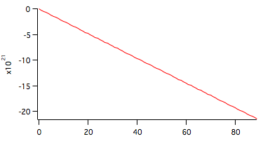

More simple system of equations is also working. I've excepted equations for holes and substituted constants.

I got a successful result with your second posted ipf! It dawned on me that the magnitudes of the error estimates would range over many orders of magnitude because the values in the solution range over many orders of magnitude. That means you need to set the scaling for the error to values that you expect from the solution. I changed your ipf with these lines:
		Make/D/O PP={9.66184*10^26, 9.66184e26,  8.05153e27,  2.41546e20,  4.32e8, 5.33e-8}
		Make/D/O Swave={1e25, 4e8,0.001,0.006,0.05,3e7}
		IntegrateODE/M=0/F=1/E=1e-6/S=Swave EquSystem, PP, Equat
The values in Swave are simply more-or-less copied from the initial conditions. You might, in fact, just do exactly that: use the absolute values of your initial conditions.
After a couple of attempts, I also changed the method to Runge-Kutta. It's not the fastest method by any means, but it is more robust- it is forgiving of discontinuities and such.

I have one further question: the equations you posted include several terms like F(x), Jn(x), etc., that appear to be functions dependent on X, but your ipf doesn't include a dependence in the input "xx". Is that a simplification of the equations, or an oversight?
