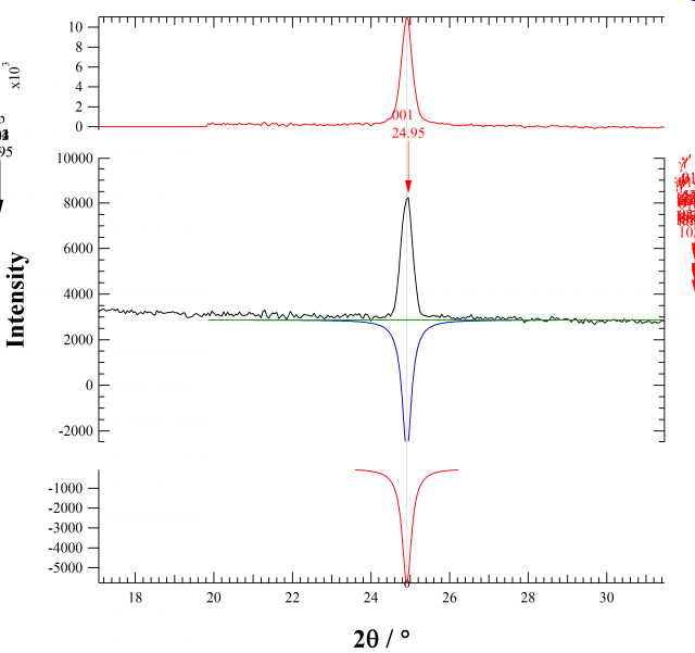

1. Was something changed with the Voigt functions implemented in Multi-Peak fit in one of the recent updates? The fitting used to work very well, but now something strange happens as i try to fit the peaks. I have attached a graph, where the resulting fit is obviously not very good ;-) After manually fiddling around and holding individual parameters it produces good fits but I didn't have issues like that when I did it the last time several month ago. No problems with Gauss or Lorentz profiles. Any ideas?

[quote=ChrisZ]1. Was something changed with the Voigt functions implemented in Multi-Peak fit in one of the recent updates? The fitting used to work very well, but now something strange happens as i try to fit the peaks. I have attached a graph, where the resulting fit is obviously not very good ;-) After manually fiddling around and holding individual parameters it produces good fits but I didn't have issues like that when I did it the last time several month ago. No problems with Gauss or Lorentz profiles. Any ideas?[/quote]
In a fit of over-zealousness, I made a change to the way constraints work in Igor 6.37 that was ill-advised. This affects Multipeak Fit because it uses an empty constraint to indicate that there should be no constraints. For Igor 6.38 I have made two changes: I backed out of my 6.37 change, and I added a check such that if the constraints are empty, it doesn't try to apply them. You can get these changes by downloading the latest nightly build: http://www.wavemetrics.net/Downloads/latest/
