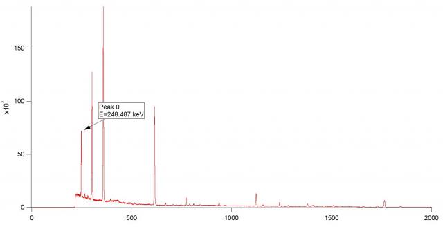

I'm fitting a lot of peaks in my data and am trying to write a somewhat efficient function to fit the peaks that I define and generate waves with the results of each fit (to include the coefficients, errors, and chi-squared information) so that I can display them in a table. My function also generates a tag which is anchored to each fitted peak containing information from the fit.

        // Create a Tag with relevant information anchored on the Centroid Peak value
        String Peak
        sprintf Peak, "Peak " + i_string+"\rE=%g keV", Coef_i(3)
        Tag/C/N=Fit1Results/X=10/Y=10 watch_kev_hist,Coef_i(3), Peak
        String Peak
        Tag/C/N=$name/X=10/Y=10 watch_kev_hist,Coef_i(3), Peak
