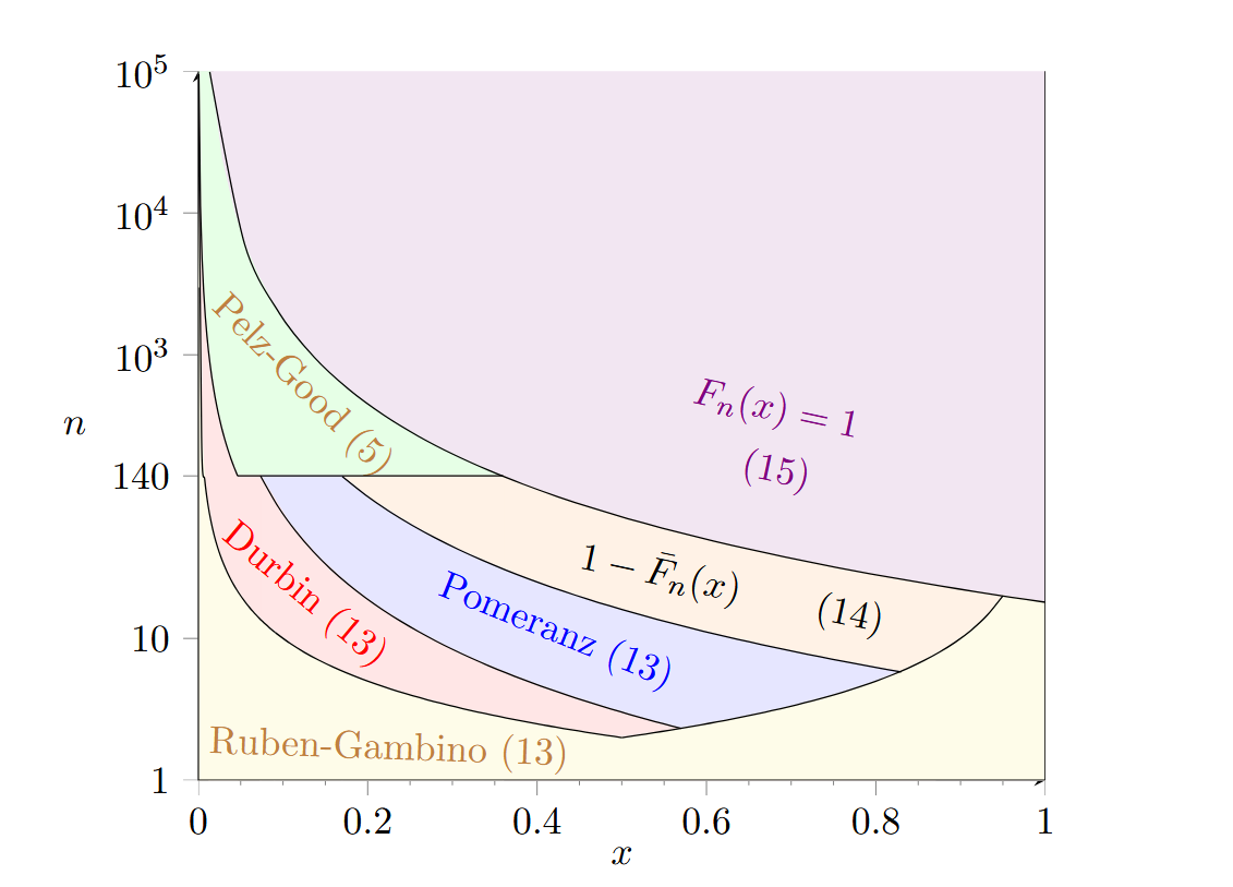

A good overview of the complexity of calculating the distribution function is provided in Figure 2 of the article.
Figure 2.
Figure 2: Choice of method to compute (or approximate) Fn(x) and minimal number of
decimal digits of precision for Fn(x), as a function of (n, x), in each region of N × [0, 1].
Reproduced from Simard, R., & L’Ecuyer, P. (2011). Computing the Two-Sided Kolmogorov–Smirnov Distribution. Journal of Statistical Software, 39(11), 1–18. https://doi.org/10.18637/jss.v039.i11. Licensed under CC‑BY.
