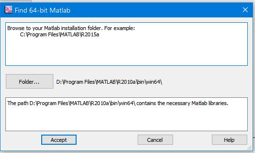

If you can install the older version of Matlab. you can also "load .mat file" directly with igor9.
On my PC, I have installed the Matlab 2010a basic without the extensive toolbox, and it does not need to be activated for the licence.
