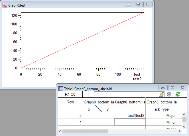

Seeking advice on how to change line in a tick label. I tried inserting \r in my tick label text wave but it creates a triangle-ish symbol in the tick label but does not change the line. Please see the image below. Kindly advise. Also curious what this symbol is about.

Now I understand that the triangle-ish symbol is actually the "return" sign. However, I don't understand why it is not changing the line within the tick label.
chozo
You need to paste a real carriage return character into the table instead of "\r". Simply copy two lines from notepad or something into the top edit cell (not the table itself or Igor will ask you if you want to paste multiple cells).
two-line tick label.png (20.94 KB)
Or click the little document-with-pencil icon at the right end of the edit box. The resulting dialog makes it much easier to enter a CR into the text in a text wave.
