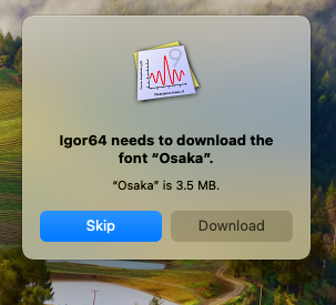

Mac asks for font downloading every time
On my M1 Mac (Sonoma in a VM) I always get the below dialog when I run Igor Pro from a shell. I've tried skipping the download or selecting download nothing persists, After a day or so the last choice is forgotten. I also downloaded the Osaka font in FontManager, nothing. Same issue with IP8 or 9.
Does anyone face the same issue? Any ideas how to resolve it?

Thanks Jim. Looks like I'm not alone with the issue, but no solution. Let's hope for the new OSX version in fall being more clever.

Still an issue ... any solution?

Sigh, should've read the link. So, I downloaded the version of Osaka from https://fontsgeek.com/osaka-font and just shoved it into my ~/Library/Fonts folder. All good. Didn't need to put it in the system-level one. Well, that solves a 3+ -year-old annoyance!

@astrotu: Thanks for chiming in. I've tried your trick and so far it works. Nice one!
