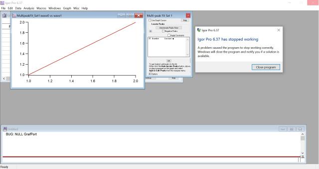

Simple error that I'm not seeing a good fix for. Whenever I try to open the Multipeak Fit 2 package in IGOR 6.37 I get the following:
BUG: NULL GrafPort
then IGOR crashes. (attached is a screenshot)
Is there a simple fix for this?
Thanks,
Mike
I would just like to add, that a few days ago I encountered the same error message on a computer from one of our users of our custom procedures. The user was running Igor 6.32a on Windows10. This was the first time in several years using my procedures that I have seen this kind of error message.
I could pinpoint the error message to a line in my code where in a panel a notebook should be created using the NewNotebook operation.
Gregor

Or you can upgrade to Igor Pro 7, which doesn't have this problem.
