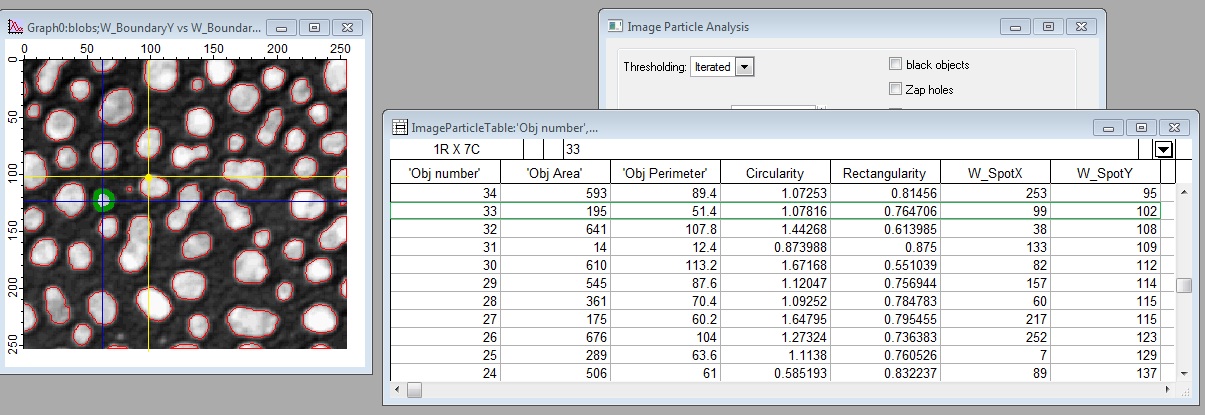

Thank you so much for your answers, but I haven’t solved the problem. As suggested by thomas_braun, I attach an example of my work with an image of the Image Processing tutorial.
According to the help documentation and Igor, in W_SpotX and W_SpotY there are the coordinates of a pixel contained in the particle. However, this doesn’t happen in this example. The selected particle in green is the number 33, if I use “Crosshair Identify” or “Labels” of “Particle Analysis”. So, in this case, the coordinates of the pixels inside the particle should be in the range of 55-70 for W_SpotX and 115-130 for W_SpotY. However, the “ImageParticleTable” show 99 and 102 for each parameter, respectively. In yellow there is the point corresponding with that position, obviously out of and far from the particle.

I think the problem here is that you are using the IP panel (which you are not completely showing us). I am guessing that you have it set to "Sort down". Instead just display the relevant waves in a table and you will find the correct coordinates of the particle. The "Sort down" does not seem to affect the last two columns in the table. You can also just uncheck the relevant box.
June 30, 2014 at 01:31 pm - Permalink
Exactly, I had the "Sort down" option activated as a default value. I didn't know it could affect the order of the data.
If I desactivate this option, I can see the correct coordinates of the particles.
Thank you so much for your comments, I have solved my problem!!
