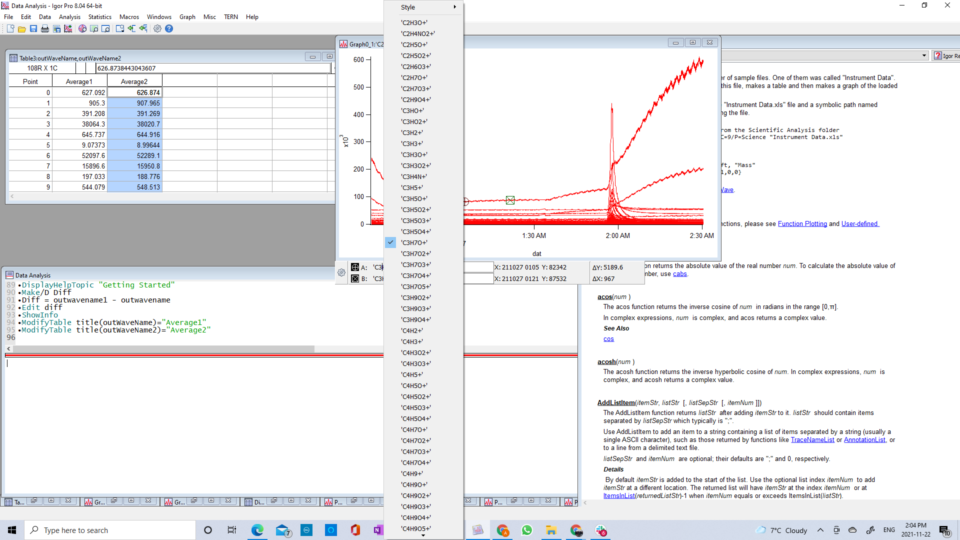

After using the function and using Edit to get my data in a table, they are registered as points instead of the name of a trace.
I am certain that the points correlate in the same order the waves are arranged (I crosschecked) but the names of the trace are also important because my plan is to create a category plot afterwards.
My question would be: Is there a way to make the table contain the wavenames rather than just points (0,1, ...)? or alternatively if I could create a list of the wavenames and make them in another table?

One suggestion is to use dimension labels.
for example you can add this line after waves[i] V_avg:
setdimlabel 0,i,,$traceName, wavgs
This sets the point label (0 dimension) at index, i, to the value of the tracename string. I am a big fan of dimension labels since it is a mechanism to have both string and numeric data in the same wave.

I've amended the code to use the dimension labels suggestion (good idea!)
If you want to make a category plot, though, you'll need a separate text wave, instead.

I would indeed need the text as a separate wave.
And this works! Thank you so much.
November 23, 2021 at 02:29 pm - Permalink
And in Igor 9, you *can* use the dimension labels for a category plot!
Simply use "Display $avgWave vs _labels_"
