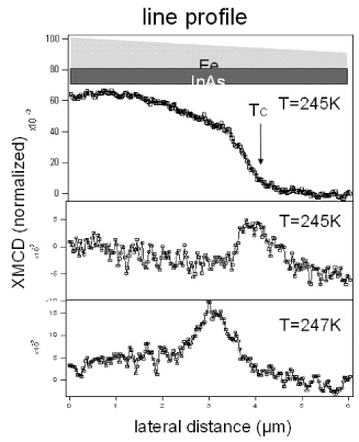

I would like to stack several graphs into one like in the attached example. Unfortunately I couldn't find an easy way to do this like on Origin.
How do you do such tasks?
Thanks
ChrLie
When appending a trace to an existing graph using the menu point you can choose a "new axis" and then use the "Draw between" and "Free axis position" in the Modify Axis dialogue to adjust the position.
