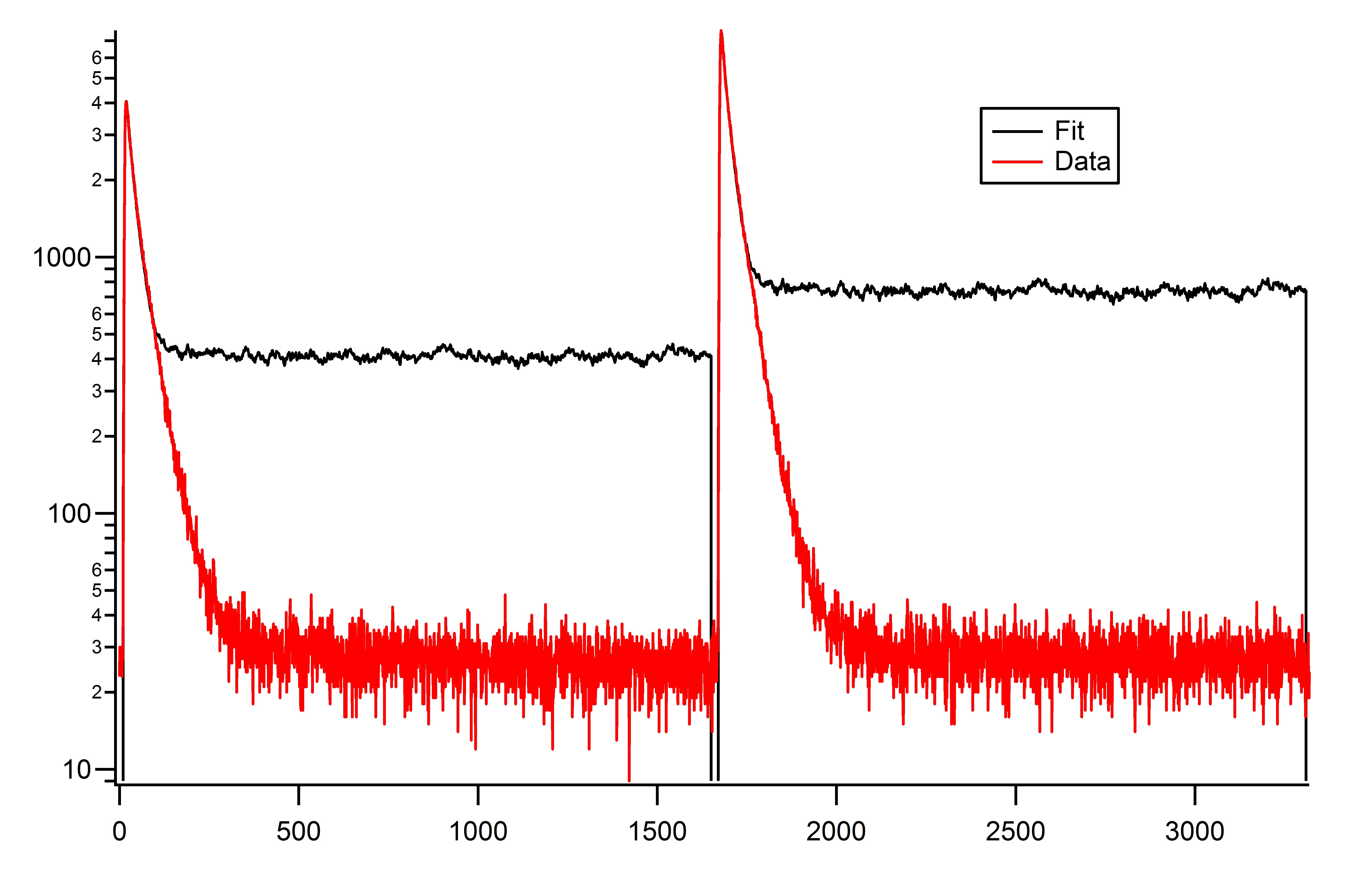

The code is currently running, although the fits seem to fail (see attached image). I'm not sure why it's failing in this manner (the fit baseline in this case was 24.2 so that parameter isn't the issue). I think the data sets may be accidentally including a few points from the next data set, so the first data set thinks it has some large values at the end.
failed global fit.jpg (880 KB)
It does look like that. It seems like a very large mismatch for so few bad points, though.

The code works normally on a single wave . Testing the Global fit on a single wave, the fit fails (giving similar results to the previously attached image).
Question 1 ) During the global fitting attempt, the coefficient wave within the fit function (checked with a breakpoint) is '_free_' . Is this normal since the global fit package keeps track of all the fit coefficients?
question 2) The global fit package attempts to fit TempYW vs TempXW. If I graph this on the same plot as YCumData, the waves are not the same (in this instance, TempYW matches the previous images "fit" wave exactly (same data points). Why is the data being fit not equal to the data contained within YCumData?
Hmm... I see that it is "helpfully" removing any non-fitted points from your data set. It removes NaNs and any points corresponding to zero weight or mask wave points. Do you have NaNs in your data?

I discovered the NaN and Zero skipping a while ago as it was causing major problems in the fit attempts (since the x-offset between the system response function (SRF) and the data to be fit is a critical parameter). Having the code remove N points from the raw data and M points from the SRF made the fits far worse than they are now.
I currently replace any NaN or Zero with a 1 (practically no effect on the fit) and manually create a sub-set of the data based on the desired fit range. I've confirmed that both the SRF and data subset waves are the ones being used for the fit and that they are of the appropriate size.

Ok, so I've tracked down my problem and, long story short, I'm an idiot. I was focused on the global fitting and waves related to it and neglected to notice a problem with the system response function (SRF). When doing a convolution fit, it is important to properly handle the baseline offset of the wave used in the convolution (which my normal code handles). Seems my routine for setting up the global fit was using the original SRF wave, with the baseline still present.
The global fitting results are now greatly improved, although tau2 (bi-exponential decay) is currently underestimated. I'll play around with epsilon values for the fit coefficients to try and get a better result.
