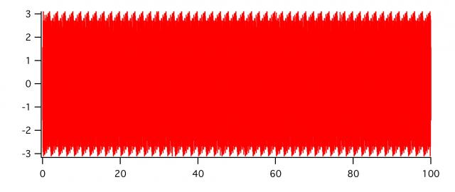

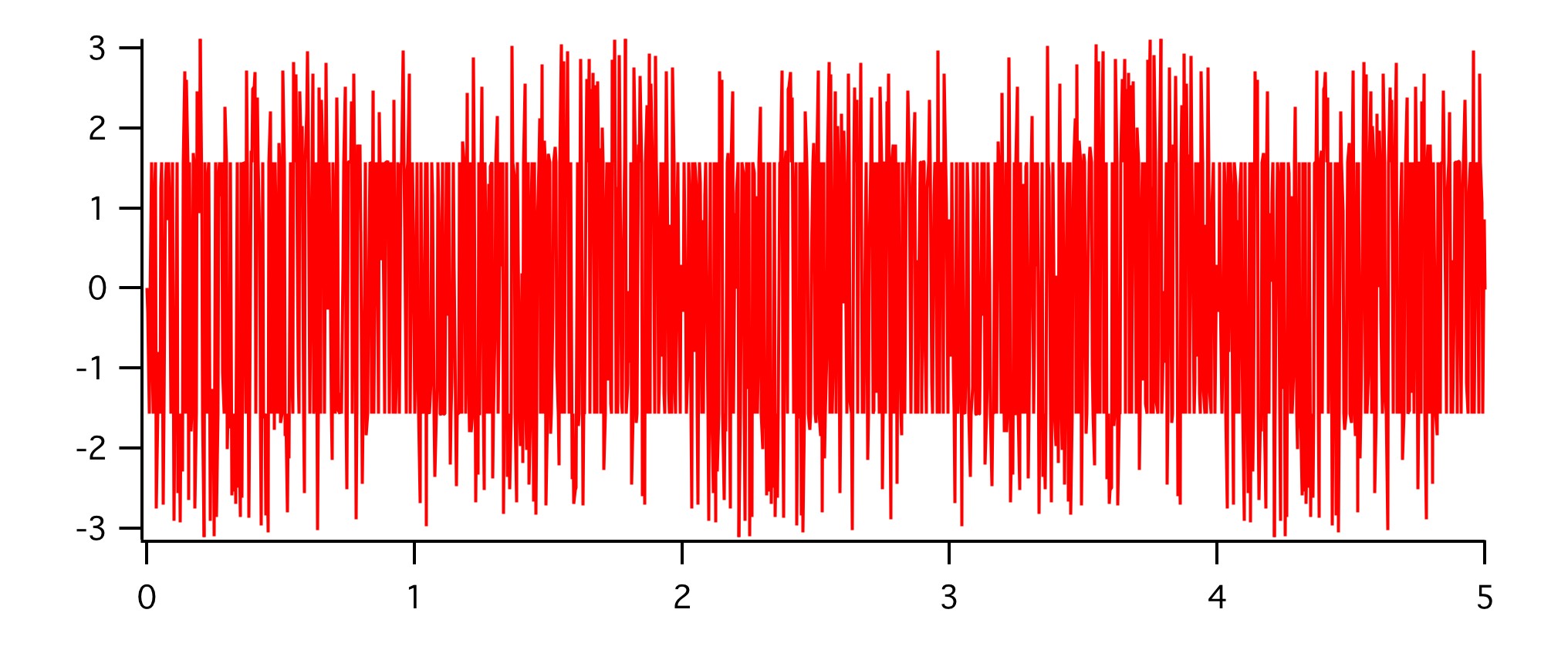

My first problem is determining the phase. Lets imagine the test function sin(2*pi*x+pi/2).
If I did everything right, the FFS complex output does not store any information regarding the phase (which in this case would be pi/2). I tried the phase output using FFT but I really do not understand what that output means since it resemble to noise scattered over a range between 0 and the Nyquist frequency.

If you want to detect phase you should consider the Hilbert transform. To find out more about this execute:
The example at the bottom of that help topic is particularly pertinent.
