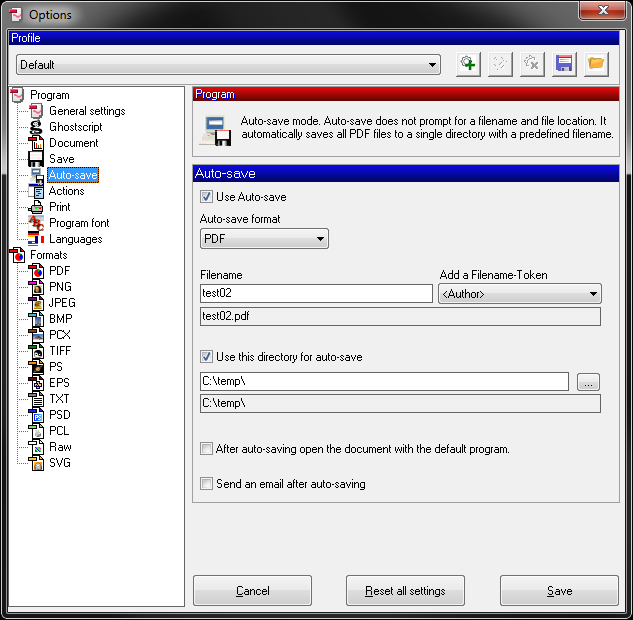

Here is a code snippet I have been using to automatically generate report notebooks as PDF-files on a windows machine:
if(AutoSaveResults==1)PrintNotebook Results // set PDFCreator or similar program as default printer with automatic saving enabled, save as "C:\temp\test02.pdf"sleep/T300// wait 5 seconds for the PDF-printer to finishsetdatafolder root:

This snippet relies on an older version of PDFCreator but I am sure that other and newer programs offer the same functionality. Attached is a screenshot of the PDFCreators Options page showing how to setup the automatic printing. Have a look at Formats/PDF/Compression when the resulting files get to large or images turn up ugly. Depending on the compression settings the PDF files are approx. 100 times smaller than the RTF-files Igor generates.
The results look pretty much like the Igor notebook but are not editable, although you can still copy the content.

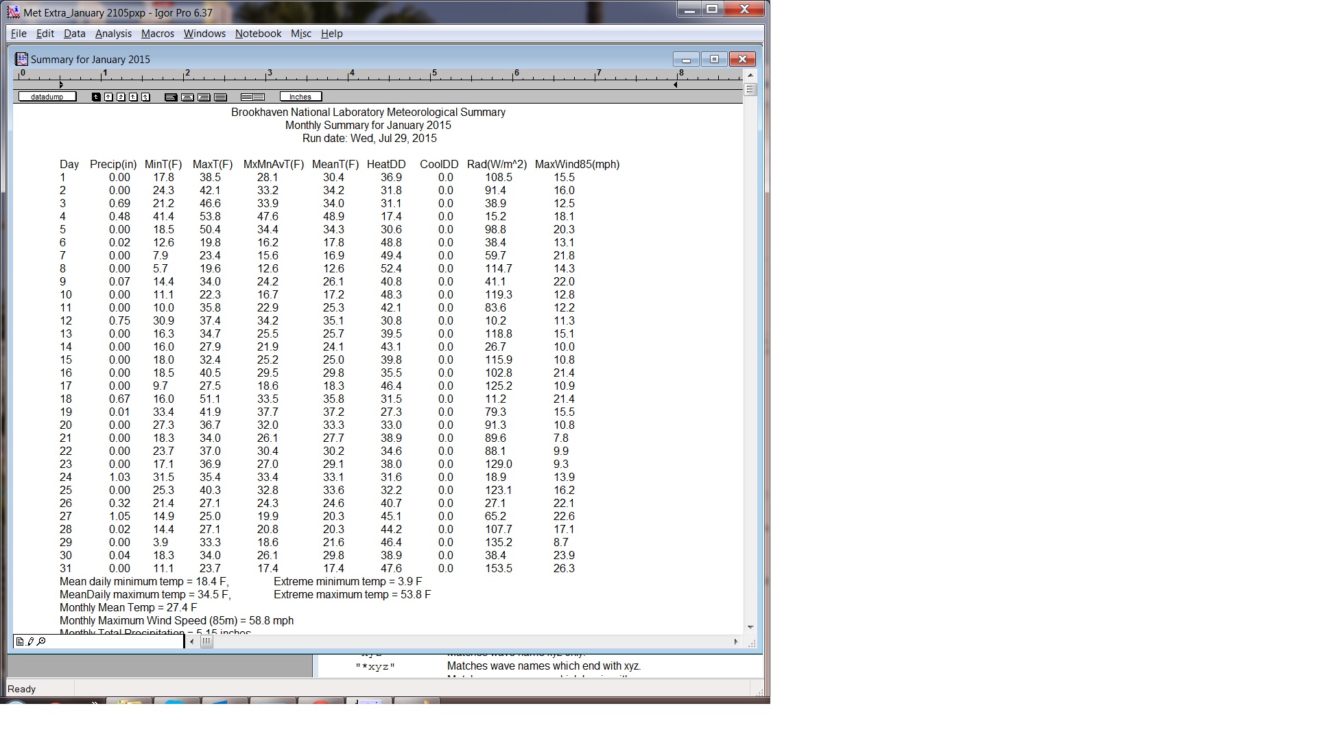

Using Win2pdf solves the pdf issue. So the next thing is formatting. No matter what I've tried the saved pdf or printed version does not look the same as the notebook window. Is there something the margins or tabs that I'm missing. I've attached a screen shot of the window and the pdf generated from it. Thanks in advance for the help.

You did not say exactly what looks different. I see that the column labels are shifted but I'm not sure if I'm missing something else.
When you print, the width of text may be somewhat different from what is on the screen. This may be caused by font substitution or rendering at higher resolution or something else that I'm not aware of.
When text gets wider, it causes text to shift to the next tab stop relative to what is on screen.
You are using default tab stops. I think you will get better results if you explicitly set the tab stops at the appropriate positions and if you make sure that there is some margin for error so that, if text grows wider, it does not push into the next tab stop.
