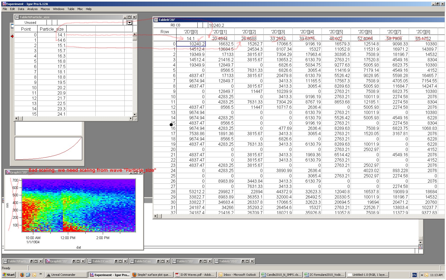

I am Igor begginer but after several hours I am not able to solve my problem, which is perhaps not so difficult. I need make an Image plot where is axis scaling set from 1D waves. In manual I found there is possible change scaling in Data->Change Wave Scaling... but there I dont see the possibility "set scaling for axis from other wave".

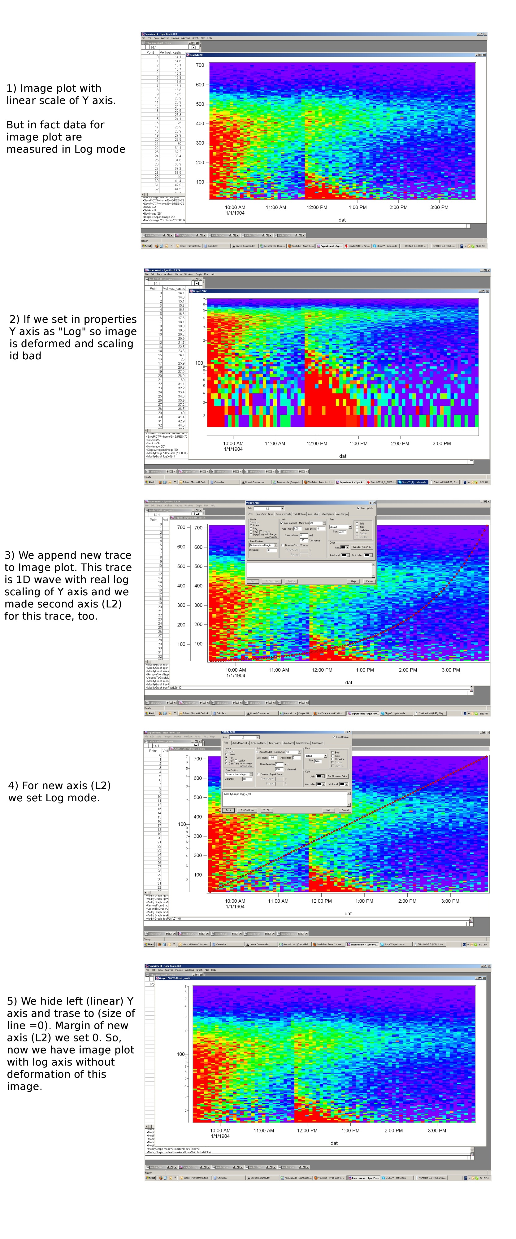

So, I have 2D matrix of data and for each column I need set value from other 1D wave. Have anybody some idea how can I do it? I am not sure if my question is clear, so I make screenshot here: http://pixarium.net/igor-screen.jpg

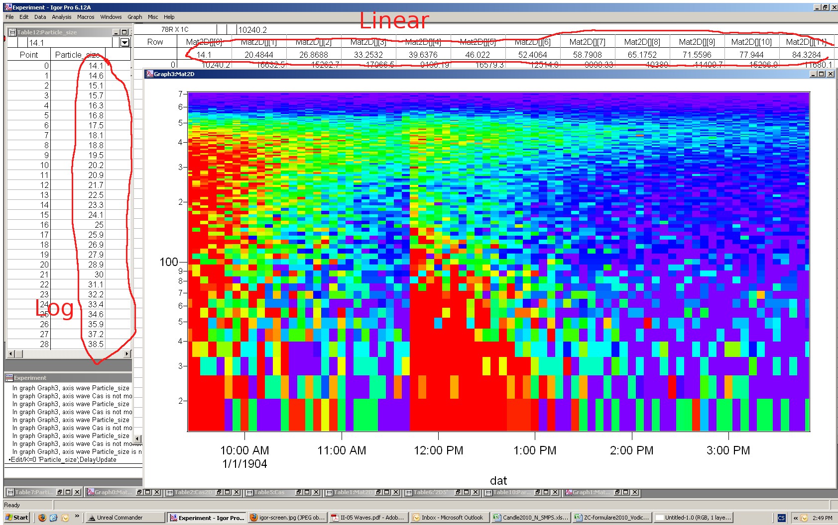

Thanks. Yes it would be perhaps solve my problem but now I find my Y axis is logaritmic. So I have 2D matrix where are time scaled data on X and log-scaled data on Y. Can I make Image plot with log-scaled Y axis without deformation of image? When I set in "Axis properties" Log-mode for Y so I have rectangles instead of square in Image plot (see sreen).

vodicka wrote: Hello again.
Well, I had dummies about this problem yet and perhaps I may say it is not impossible ;-) In attached file is several screens with my solution. Perhaps it is not clear solution but it is functional ;-)
Petr

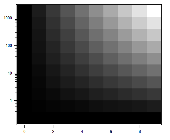

Another way is to create a 1-D wave with one more point than columns, and assign exponential values to it, and use that to provide the Y coordinates when you use AppendMatrixContour.
Macro DemoLogSpacedYImage()
	Make/O/N=(10,10) twod=p*q
	Make/O/N=11 yvals= exp(p-2)
	Display /W=(210,64.25,626.25,407)
	AppendImage twod vs {*,yvals}
	ModifyImage twod ctab= {*,*,Grays,0}
	ModifyGraph log(left)=1
	ModifyGraph mirror=2
