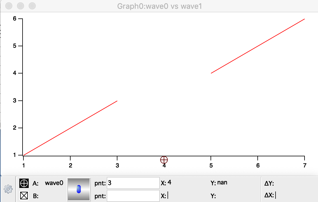

If the cursor is placed on a point that contains a NaN value, the info window will display NaN in the appropriate box. You can't drop the cursor on a NaN, but you can use the Cursor command or the arrow keys to move the cursor onto a NaN value. If the cursor is moved to a point that has a NaN value, it will move to the edge of the plot area, as shown in the attached screen shot.

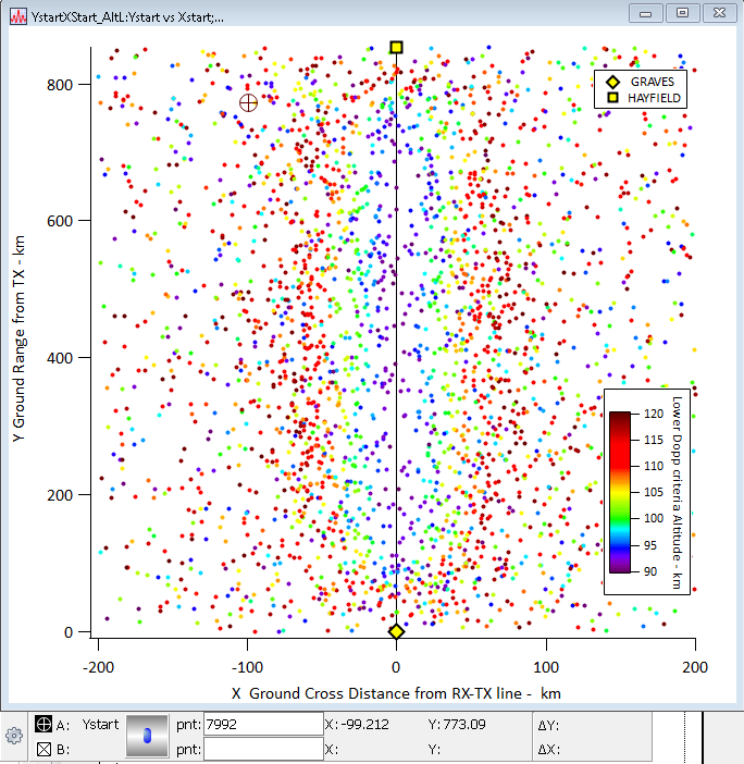

This is not what I get on my scatter plots. The first creen shot shows the curors dropped on to a space on the graphic and a point is indicated that shows an xy value and, correctly, no marker because the corresonding f(z) value is NaN. An expanded shot, moved to a close by wave point also shows no marker but here the f(z) value is a number. So the NaN points are not high lighted by the info cursor and the scatter display does not correctly show the marker for where the number is valid.
My problem is that I want to display valid numbers only and I am not sure that I will get that!

Your two screen shots show the cursor on exactly the same point number 7992 but maybe it's just a faulty upload.
If you think there is some inconsistency it would be best if you could share the data and include a step-by-step description how to reproduce it.

I will just restate (correctly) what I am doing from the beginning. I have a scatter plot of X and Y waves to show the distribution of 20000 randomly generated points. Various other parameters are calculated relating to these points. To focus on one particular aspect of one of these parameters I filter out various values by setting the values to NaN. I then use the f(z) option for the markers to colourise using this filtered parameter containing the NaNs.
The scatter plot didn't look as I expected it and that led me to investigate the displayed points using graph info. It was at this stage that I found what I thought was a discrepency between what the cursor indicated as a valid value and the actual value as shown in my pngs above.
I have circumevented the issue by making new waves containing the valid values of the z parameter only and for the corresponding values for X and Y. The new scatter plot using valid points only looks the same as the previous one that included NaNs. So, the data on the original plot was displayed as it should have been.
Thanks for all the advice. My issues are now sorted out with the new plot, from my point of view the query is completed.
