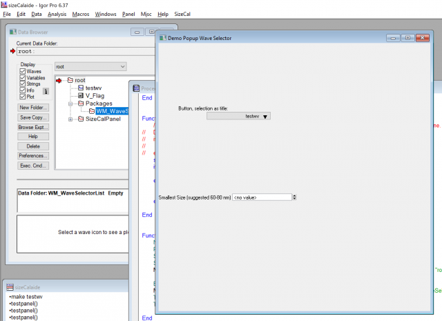

I am trying to make the popup menu for setvars work outside of the WaveSelectorWidgetExample. If I open up the example .pxp and open the Popup Wave Selector Panel from the macros menu, all of the SetVars work fine.
However, in my own panel, the setvars seem to not be initiating..the popup itself is not working and the variable text simply shows "" when I start up the panel.
Here's the code, mostly copy/pasted from the example.pxp which is why this is so confusing that it does not seem to work (obviously just trying to get it to work at all before I do anything with the panel)

Even copy/pasting your code into a new pxp, however, yields the same issue. The button has no problem being a popup, the setvar (hidden because the sizing of the window/positioning of the setvar is off) just says "no value> or "no variable> and does not become a popup.
Using 6.37
It seems that the issue is the variable not initializing...i.e. copy/pasting your code into a new pxp and running testpanel() creates a directory root:Packages:WM_waveselectorlist but the directory is left empty (as opposed to how it populates in the wave selector widget example pxp)
You are passing "root:" as the name of the global string variable to be associated with that popup. The function returns an error code, but you haven't used the return value. This works:

Thanks John, that did it. It was not immediately clear to me that simply making a setvar via panel or code did not automatically initiate/create a variable. I thought the root: call in the popupbutton function was to point the function to a directory to create the setvar.
